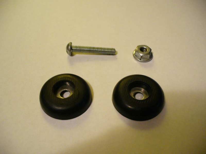

rokinn Posted November 13 Share Posted November 13 This is what I did. Put the two half flat sides together, run the bolt through and tighten it down to the E brake. Recommend a lock washer or nylon nut. Mine was a little loose when I looked at it. I think I got the bumpers from Home Despot. Works well although I think I am going to look for nylon lock nuts. Link to comment Share on other sites More sharing options...

Eagle_SX4 Posted November 14 Share Posted November 14 For anyone wondering the hole for the rubber bumper piece is 5/16 diameter. I am having a hard time find a suitable replacement. Most places don't list sizes of the bumpers they offer and those that do don't have the correct size. Link to comment Share on other sites More sharing options...
TheNerfsmith Posted November 14 Share Posted November 14 If we can’t find replacements what about making them. For example printing them out of TPU on a 3d printer if we have the measurements to make it in CAD. Link to comment Share on other sites More sharing options...
