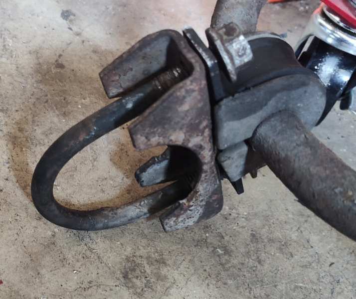

There is a lot of space between the carpet and the floor boards so a leak may not cause the carpet to be wet. Pulling the carpet is a lot of work requiring all of the interior plastics and seats (not the dash) to be removed. It is unlikely that a heater core leak wouldn't leak out the bottom of the cab somewhere. If you can, get under the cab and check for any antifreeze on the bottom side of the floor boards. -
