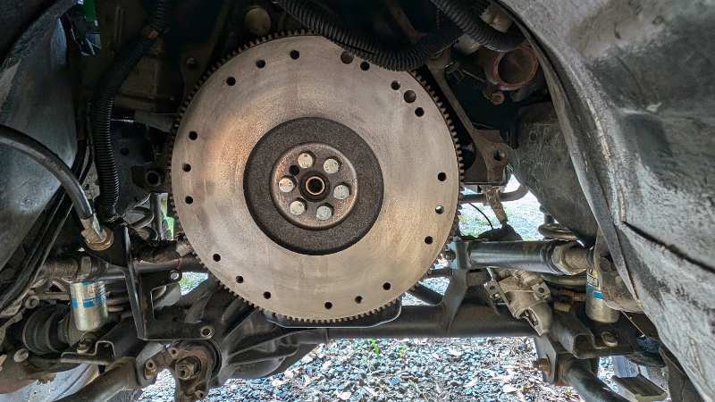

Well, yesterday I got the Camaro flywheel, centerforce clutch, and Camaro pressure plate installed. Looking at the Camaro vs S10 flywheel it's no wonder the input didn't touch the clutch. No pictures, but I did get the AX15 and the transfer case bolted in, along with the Novak shifter. Now I have to figure out how to mount the transmission. My truck being an 86 I can't move the crossmember on the frame. So I think I'm going to cut up the crossmember and just weld in a plate and drill holes to accommodate the AX15 stock mount. The output on the t-case is only 1/4" further from the diff, so my new driveshaft should be fine. -

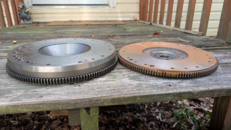

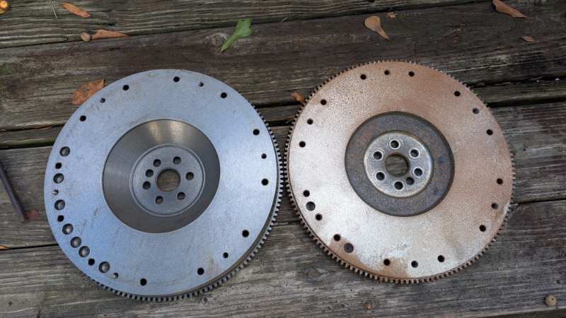

Well, I feel real dumb. Looking through my parts numbers I realized my mistake. For some reason I convinced myself the later S10 2.8 and the Camaro 3.4 uses the same flywheel. They are essentially the same, but the 3.4 has about 20mm more in the crank to friction surface measurement. So, I ordered the wrong flywheel
Looking for input here. Swapping a 1990 AX15 onto the 3.4 in my truck. Done quite a bit of reading on people that have done the AX5-AX15 swap in 2.5s, but very little info about putting it on the 60° v6s. I kind of assumed that most of the advice would cross over, and it has, but I shouldn't have assumed anything given there's no actual documentation on this swap. The issue I'm having is that the input shaft of the AX15 is not engaging the splines on the clutch and I'm not sure how to fix it. From the surface of the back of the engine, the clutch splines stick out about 38mm. From the face of the bellhousing, the input shaft splines are 35mm inset. When everything is bolted in place I can freely rotate the output shaft and feel the input shaft spin with the trans in 4th. Not entirely sure what to do from here to try and get those spline to meet. I can't flip the clutch disc because the springs interfere with the flywheel bolts. Anyone have any thoughts?

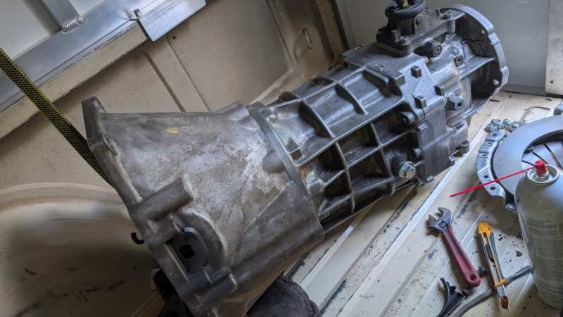

4L60e is out of the truck. Have installed the new flywheel on the engine and have the AX15 reassembled in the bed. Unfortunately the clutch I ordered won't work. The snout for the input shaft splines is too pronounced and hits the crank before the friction surface is touching the flywheel. Instead of getting a shop to cut that down I ordered a Centerforce clutch that in the pictures has a much smaller snout. It should have better friction material than the first one I ordered anyway so why not. -
