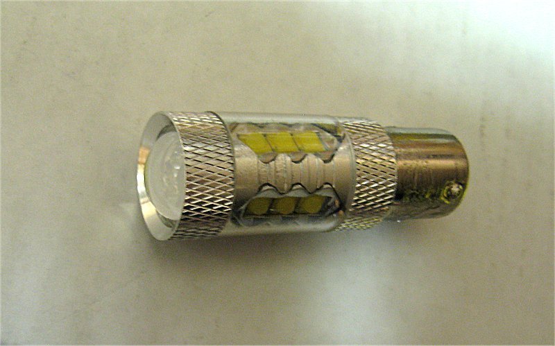

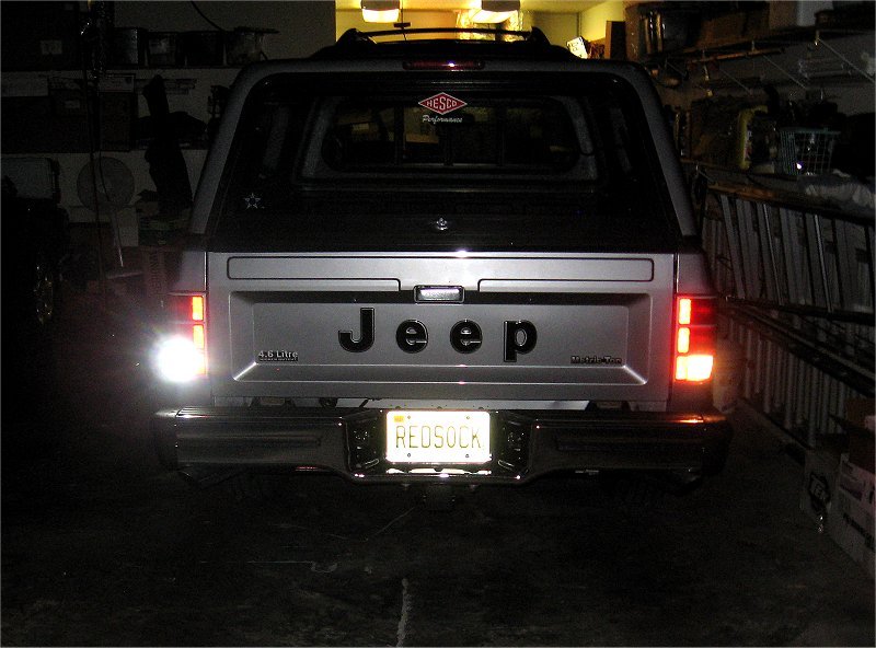

HOrnbrod Posted April 24, 2016 Share Posted April 24, 2016 I currently have halogen 1156 bulbs for my backup lights, but they left a lot to be desired, plus they drew about 1.5A/each. I'd heard good things about these CREE LEDs so I thought I'd give them a try. I picked up a pair of Genssi 80W 1156-compatible bulbs with the Cree chipset on Amazon for less than $20 shipped HERE. I suck at taking pics at night, but these bulbs are at least twice as bright as the 1156 halogens and draw less than an amp total. They are focused pretty well for a straight back beam, not just splashing the light in a useless halo. Well worth the $$ to me. Hopefully they will have a long life. Link to comment Share on other sites More sharing options...

gogmorgo Posted April 24, 2016 Share Posted April 24, 2016 80 watt bulbs? Geez, that's not much of an increase over the 26W 1156's... I wouldn't be comfortable tripling the power of the bulbs on factory wiring. As far as the lights themselves go, I'm kinda tempted. I do too much reversing in the dark, and I've always wanted something more substantial. How do you conclude less than an amp draw? 80w/12v= 6.7A, per side. Link to comment Share on other sites More sharing options...
HOrnbrod Posted April 24, 2016 Author Share Posted April 24, 2016 The 80 watts they claim is what it would take an incandescent bulb to produce the lumen equivalent provided by this LED bulb, so Ohms law doesn't apply. Advertising wordsmithing as all LED bulb manufacturers do. I stuck my ammeter in series using test leads and verified slightly less that a one amp draw on the 10A scale for both LED bulbs. No worries for the factory wiring........... Link to comment Share on other sites More sharing options...
gogmorgo Posted April 24, 2016 Share Posted April 24, 2016 :thumbsup: I was kinda wondering, looked a bit compact for 80 actual watts of led, and also not very bright. I've got 72 actual W of led on the front of the MJ, and it's like staring into the sun. :D These will for sure get tossed into my next amazon order. Link to comment Share on other sites More sharing options...
