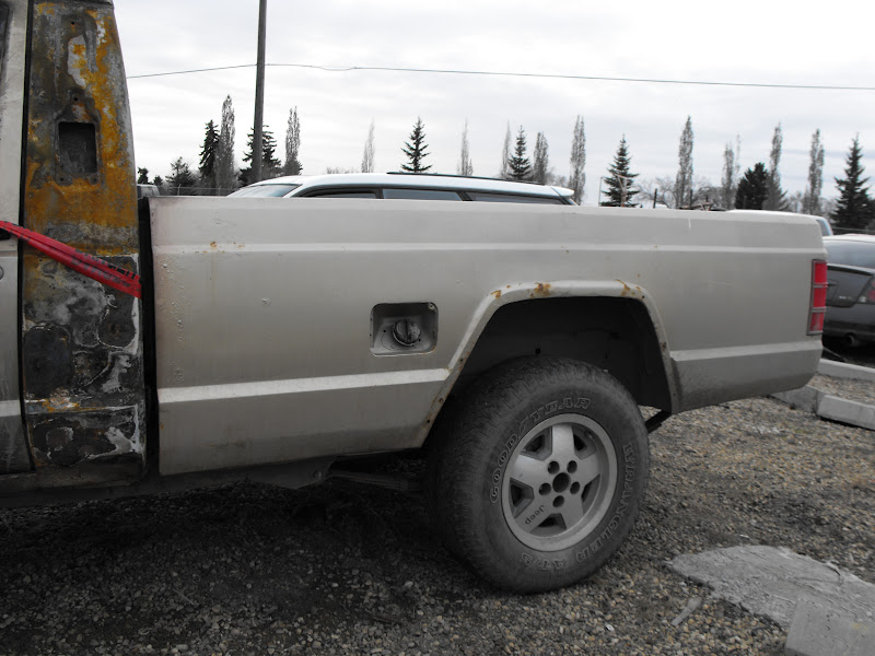

Burke Posted April 6, 2016 Author Posted April 6, 2016 So can any of you please help me evaluate the value $ I have left in parts here, 1989 Comanche Pioneer Metric Ton. I see surviving: 5 wheels & tires D44 (completely new brake hardware, drums, pads, springs, hoses, wheel cylinders) D30 w/vac disconnect NP231 (hopefully not destroyed) BA10 (I'll assume it's value is $0.00) Engine is toasted (literally so also $0.00) Both Tail lights Near perfect tailgate Front bumper Rear leafs (although they are pretty bagged) Bucket seat mounts (may be iffy however considering new aren't available...) 7' Box in salvageable condition In the garage: Inner rocker covers Good hood exhaust header 2nd set of taillights 2nd tailgate (needs work) Yeah I'm probably stretching it thinking I have much value, but MJ's are not easy to find around here. Thanks in advance, Burke
gogmorgo Posted April 6, 2016 Posted April 6, 2016 Looks like it could have been a lot worse... you still have four tires holding air. Depending on how hot they got the heat treating in the trans and t-case components could be negatively affect. There's a chance as well the fire could have gone into the shifter boot and turned the trans into an oil lamp I suppose. If you drop the fluids out and they don't look burnt they may have survived. Same for the motor, although it'll need new seals and it'll be a bugger to get all the scorched plastic off it. The bed looks like it lost a lot of paint up by the cab, which could always be fixed, but the metal may have gotten brittle from the fire. I think I'd leave the front bumper or the seat brackets for that reason, but the bed's in pretty decent shape over all. Looks like the rest of the MJ back end stuff is all still good, which is definitely a plus, including all the metric ton stuff, less the window sticker(?). Definitely a lot of good parts left on it. If it was mine I would try to get it back, strip it down, and then get rid of it quickly before I got too angry from looking at it. People suck. :( Hope they caught the a$$hole.
DirtyComanche Posted April 6, 2016 Posted April 6, 2016 I'd write off the front tires. They are time bombs if you try to use them. The D30 might need new seals and the ball joints may not last long after that. Brake calipers might not be okay either. Otherwise it should be okay. Forget the engine and Trans. The engine might be good for a core, but I wouldn't even do that given that I could get a better core for nothing. 231 might need new seals, I doubt it got hot enough to really wreck it, however they really aren't worth anything (I started throwing them out) and would find a known good one before bothering with that one. So, I think you've really got a box that can be fixed, a tailgate and lights, a set of rims, a rear axle, and maybe a fuel tank and some odds and ends. Value is subjective, but I could sell that D44 for $400 easy, so I'd probably go as high as $700 or so. But I know I could use that box (I have one that had a tree fall on it). Really up to you what's it's worth though.
Minuit Posted April 6, 2016 Posted April 6, 2016 Good thing you got that slimy piece of $%#%'s face in the frame. I don't usually call people anything approaching "slimy piece of $%#%" but the situation demands it. Not much consolation considering you got to watch your truck being carted off to its doom in very clear detail. I'd write off everything in front of or at the cab. The heat damaged parts in ways that probably wouldn't be easy to notice. All the bearings and seals in the front axle, trans and T-case were likely severely overheated by the fire and won't ever be the same again. At the very least the T-case would need to be rebuilt. As gogmorgo said, check the fluid. The rear suspension and everything attached got off easy. Check the front of the bed for warping and cracking. I wouldn't trust anything within about a 5-7 foot radius of the cab to ever work properly again. Bed is a big maybe if it didn't get "customized" in the front by the heat. All said, I'd say you have $500-$1000 in parts if you assume $400 for the D44 (I wouldn't pay that much unless it didn't need any work at all, but hey), $100 for the springs (they can be re-arched if someone cares enough), $50-100 for the tail lights, $50 for the wheels, $100 for the tailgate, and however much beds go for for the bed assuming it's still usable + the extra stuff you have. I can't see a much better argument for garaging an MJ. These things are rare, beginning to appreciate in value, and very easy to break into what with their GM steering columns and lack of any security features whatsoever. Not that that helps if you don't have a garage, but I know mine won't be parked outside again once it gets painted.
Megadan Posted April 6, 2016 Posted April 6, 2016 I'm a crazy optimist. I would strip the front panels. Have it media blasted, and then bake it in a powdercoat oven at 400-425 degrees for a few hours to temper the metal. Then go find an XJ and steal EVERYTHING for the front end.Best idea in the world... no. But, I'm nuts. :yes: Hopefully you can find another one if that's what you want. I would say keep the parts off of it in that case.
