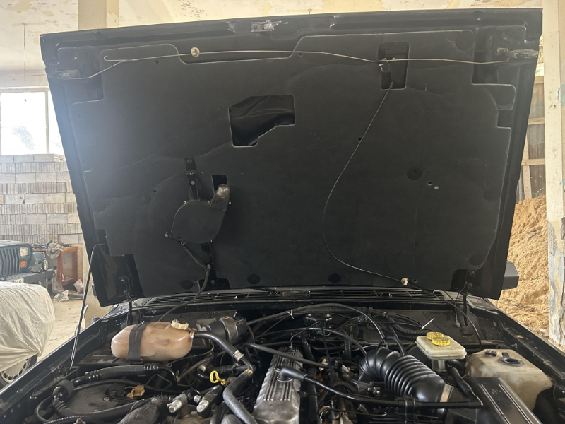

Eagle_SX4 Posted yesterday at 01:04 PM Posted yesterday at 01:04 PM My truck has the factory hood insulation on it I will get a pic later today.
Eagle_SX4 Posted yesterday at 04:23 PM Posted yesterday at 04:23 PM Here is what mine looks like. It does appear to be cut the same as the pic in the first post.

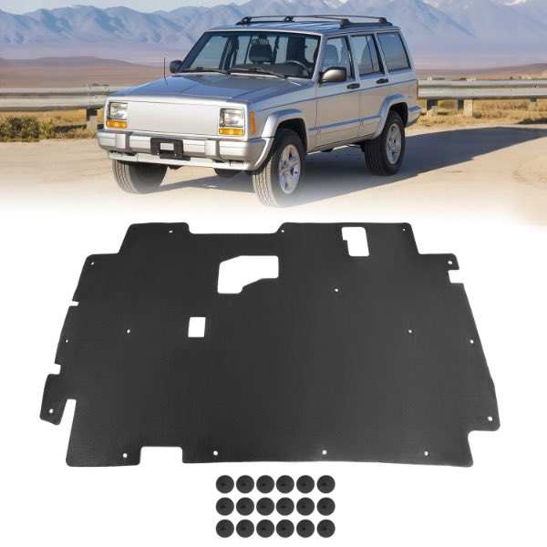

AnotherOldJeepGuy Posted yesterday at 04:45 PM Posted yesterday at 04:45 PM 19 minutes ago, Eagle_SX4 said: It does appear to be cut the same as the pic in the first post. Yes it does. Can't tell if the new one is molded or flat from the pic for sure, but it looks flat. Also curious of how it is attached. I don't see any plastic bolts holding yours in place so the guess is it is stuck there with adhesive instead. Which also suggests you have to drill holes to install the new one with the fasteners provided.
Eagle_SX4 Posted yesterday at 05:08 PM Posted yesterday at 05:08 PM 21 minutes ago, AnotherOldJeepGuy said: I don't see any plastic bolts holding yours in place so the guess is it is stuck there with adhesive instead. Which also suggests you have to drill holes to install the new one with the fasteners provided. There are plastic clips holding it up they just blend in with the years of dirt. If you look closely at the right side of the pic I took you can see three of the clips.
Eagle_SX4 Posted yesterday at 05:10 PM Posted yesterday at 05:10 PM After looking at my truck again there are clips at all the places the holes are at in the pic from eBay.
fiatslug87 Posted yesterday at 07:05 PM Posted yesterday at 07:05 PM I added it to all three of mine. This one is molded. https://ebay.io/m/PXbtQZ
