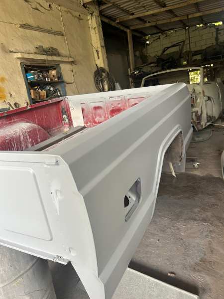

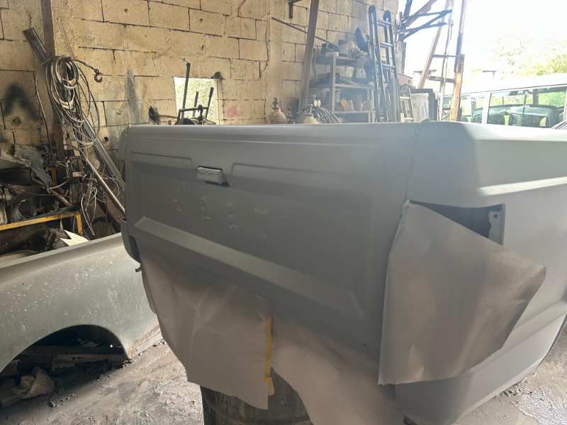

1990 Eliminator at paint shop
MagicJames replied to OzarkGuy's topic in Member Projects: Your Comanches
Lovely stuff. The tailgate looks very acceptable; keep us updated -
