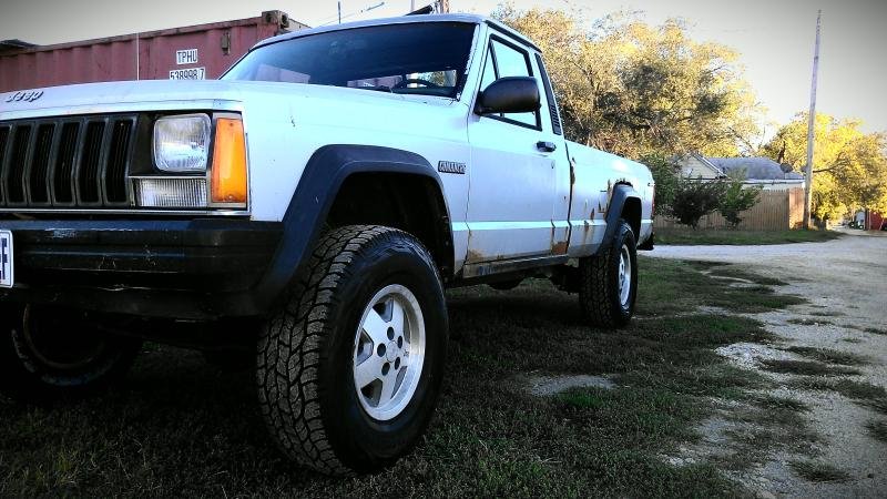

  11. Look ma', NEW SHOES! 265/75R15 Cooper Discoverer AT3

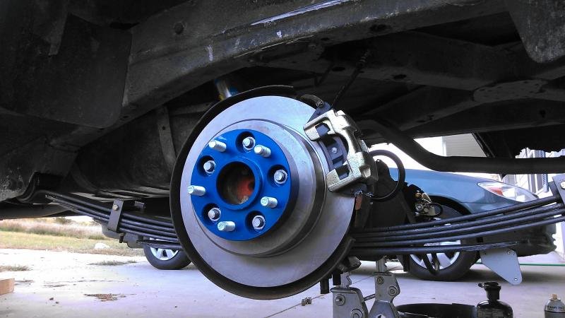

  20. Parts finally started to roll in to get the rear end buttoned up. First up was the NAPA rotors and SpiderTrax spacers. Followed by loaded Centric calipers and Dorman hoses, all for a 1998 Explorer of course. I picked up set of gently used Bilstein 5125 shocks from Hornbrod intending to use them on my 92 build. They seemed too perfect for this truck so I elected to go ahead and use them. I then ran into a snag with the lower shock mount. Very few folks swap in the 8.8 and keep it spring under. The small shock mounts that come with the 8.8 swap kits would effectively mount the shock 4" higher than stock. That is not acceptable to have any travel in the rear. I ended up modifying a TJ shock bracket that came with a MAD4x4 8.8 swap kit I never used. I really need to install a new bumpstop and reconfigure the brake line mounting. I dropped her back on the ground, installed the front driveshaft and a new V8 ZJ draglink then went for a drive. The truck rode very smooth, the 8.8 was nice and quiet, and the brakes work phenomenally.
