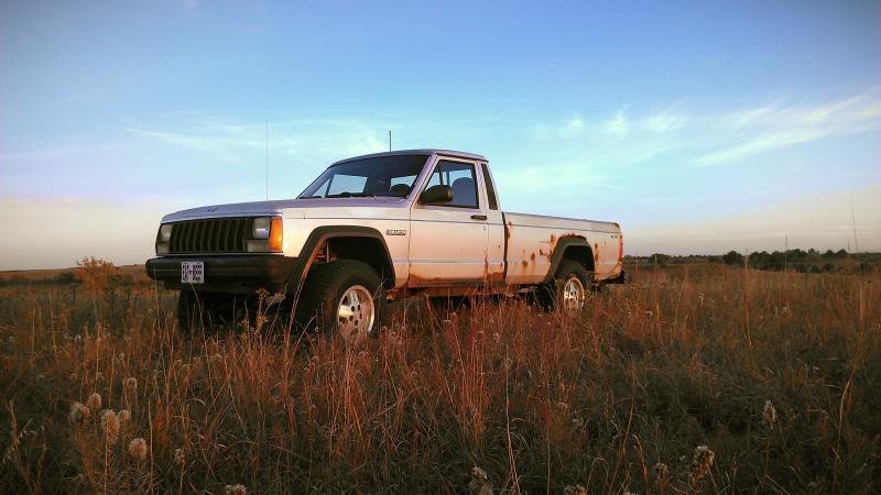

For a reference, here is my truck with about 3" of lift and 265/75/15's. I opted for the 75 as the tire was dimensionally narrower (by a little) according to Cooper. The AT3's ride nice and the 2.5 with 4.10's spin down the road without problem. My experience with them on a 2500 Duramax proves satisfactory in snow, even though they don't have the "mountain snow" rating. I've only been able to use them in the small 3/4" of snow we got 2 weeks ago with the MJ. Seemed to work great.

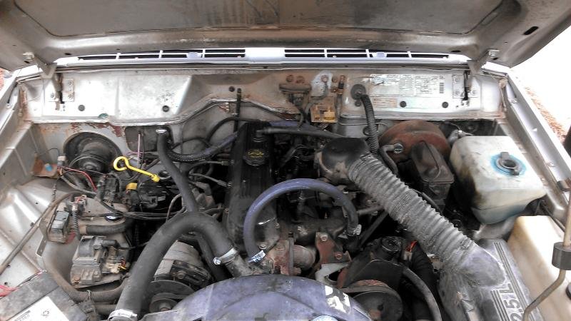

The truck has been a pleasure to drive this last month. With the fresh suspension, balanced tires and an alignment I imagine this is how somebody driving a brand new MJ would have felt. What does EVERY MJ interior lack? Light. I located a lighted rearview mirror I bought for my 92 three years ago while organizing my parts stash in the garage. Mounted the windshield button and wired it up to come on with the B-pillar lights. Since I had ZERO issues with the truck over the last month I felt it was time for another road trip. My destination, Kansas City, to help a buddy apply Raptor liner to the interior of his XJ. The morning was brisk but clear. As I loaded up the truck with gear, it heated up and defrosted. An hour into the trip I lost heat. The fan was blowing cool air and the vent selector was working just fine. When I pulled off at a Rest Area I suspected the heater bypass valve failed. Sure enough, even with good vacuum the valve wouldn't hold its position. I suspect the vacuum diaphragm gave out. I finished my trip with no heat and was ever grateful for the sun warming the cab. I immediately did the bypass elimination when I returned home. I am not happy with the non molded heater hoses, but they work. Noticed my high pressure power steering hose is leaking, so I need to buy one of those! I only averaged 15mpg at 75-80mph with a 30-40mph cross wind. -
