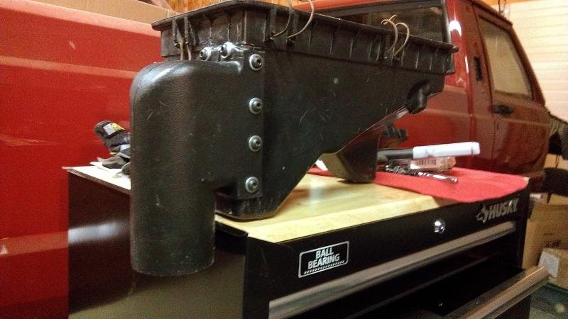

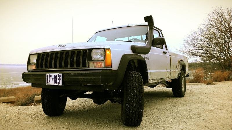

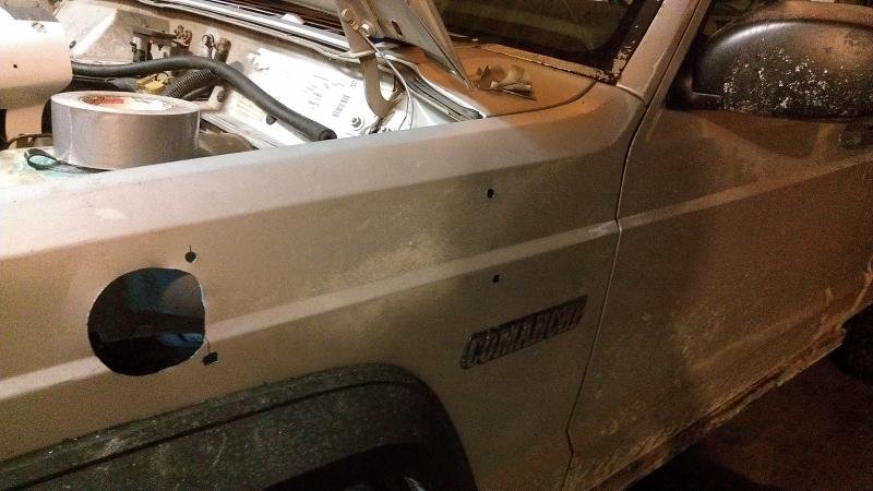

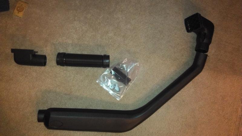

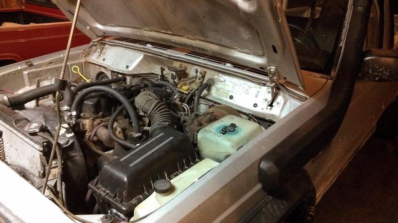

  8. Its time for an update. My overall goal for this truck has slowly been transforming from a basic daily driver to a test mule. Test mule for what? Overland/adventure gear I will eventually incorporate into my '92 build for a cross country trip, when the time comes. This will primarily consist of solar/power equipment, bed storage, skids and recovery gear. My goal is to iron out any wrinkles in my gear prior to installing it on the '92. Since I will try and push my gear beyond my intended use on the '92, I have to get this truck up to snuff. First step, snorkel. http://amzn.com/B00B90NGBK Since I am building this truck on the cheap, I opted to give the China made Amazon snorkel a try. My first step was to clean up a HO 4.0 air box to use in the truck. I opted to use the HO air box since the filters are easily found at the parts stores (unlike the 86 air filters) and it eliminates the vacuum doors in the air box. I fastened the snorkel adapter to the front of the air box with button head bolts with lock washers and sealer. First 3" hole drilled into the truck after test fitting the air box. Measure, measure, measure. Then drill! My measurements were vastly different than the template provided. You have to elongate the the 3" hole towards the back to allow the curved snorkel tube to fit through. Test fit the snorkel body, crossing your fingers that you measured correctly. Not pictured is the a-pillar bracket riveted to the windshield frame. I used my own stainless rivets not the provided rivets. HO air box plumbed in to the 2.5 TBI unit. I am not crazy about the twist in the intake tube, but I highly doubt it will affect the 2.5's performance. Installed and ready for action.
