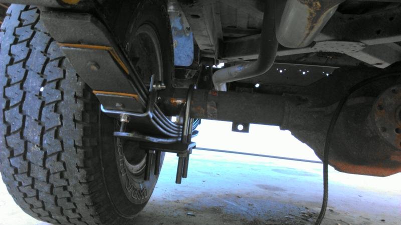

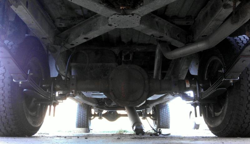

  2. Rebuilt leaf springs. Added an extra leaf by cutting the eyes off of an extra MJ main leaf. I coated each leaf in POR15 and Slip Plate and replaced the worn out anti-friction pads. I had to build new spring clamps as well. Oh hey, that sure is a funny looking Jeep axle... Got the 8.8 loosely under the truck. Still need to get the shock tabs welded to the housing. Using the Ruff Stuff kit let me position the axle 1" to the back which will allow me to use the stock driveshaft. The truck sits great with the AAL and larger 8.8 axle tube. Waiting for the spacers and brake parts to finish it up.

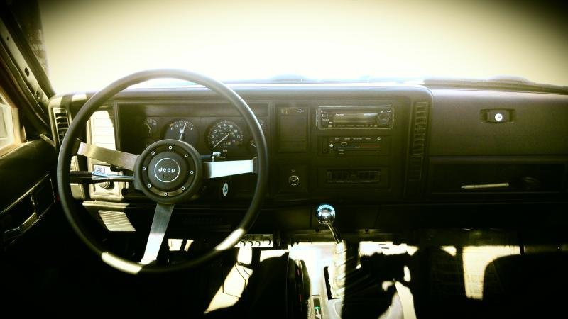

  3. I just installed a Rampage shift knob on my AX5 with the 10mm threads. Nice simple solid aluminium knob that can't fail like the factory piece.
  4. After owning this truck for almost 3 years, I finally decided to fix three of its biggest annoyances. 1. Replaced the front output seal on the transfercase as it always left a pool of blood under the truck. I used a Timken seal that was designed much differently than the seal that was in there. Hopefully it is an improvement. 2. The shift knob. The stock knob would spin in circles and, sometimes, it would pull off of the shifter...not fun. Replaced it with a solid aluminum shifter from Rampage. Sure it was a little more expensive than a stock replacement, but it should never fail in the same way. 3. The Cessna yoke steering wheel had to go. Replaced it with an extra traditional 3 spoke I had laying around. This project isn't complete though as I still have to install the NAPA horn repair kit. Not a big deal since I can shout louder than the horn in this truck. A new headliner is on the way, so maybe I will finally get those A-pillar trim pieces installed. The 8.8 also got new perches welded on and I have begun pulling apart leaf packs to give the truck a little boost. I will be coating each leaf in POR15 followed by Slip Plate then put together with grade 8 hardware.

  9. Thanks. I won't worry about locating a new yoke nut. Admittedly I've never done this work before, but I am a bit confused about the silicone on the splines. I assume it is there to create an oil seal between the yoke and output shaft. I did not see any mention of that in the FSM. Granted I may have missed it.
  10. Absolutely. A new set of MT springs would be great..... but they are kind of pricey for this budget build. I know several members here have had great success building their own leaf packs for their trucks and I would like to do the same.
  11. I am looking for an effective way to gain 1-2" of lift in the rear end of my '86. Right now it is running stock 4wd leaf springs and Chevy lowering shackles. I am happy with the ride height the truck is at now, but anticipate I will loose about 1" of ride height when I swap the D35 for a 8.8 on Ruff Stuff perches (staying SUA in stock configuration). My stock leaf springs are pretty soft and sag quite a bit with a light load in the bed. I'd love to reduce the amount it sags with a load as well. After reading through several AAL and bastard pack threads, I believe I have come up with a decent plan to gain a little lift and carrying capacity. I will use my 4wd MJ main leaf followed by a 2wd MJ main leaf with the eyelets cut off as the AAL. Beneath the AAL will be the rest of the 4wd leaf pack. I believe this will accomplish what I am after since the 2wd leaf pack has more free arch than the 4wd pack has with the weight of the truck on it. If the resulting leaf pack yields more lift than I need, I can correct that with the shackles. I've never tried my hand at building a leaf pack. Let me know if my line of thought is correct.

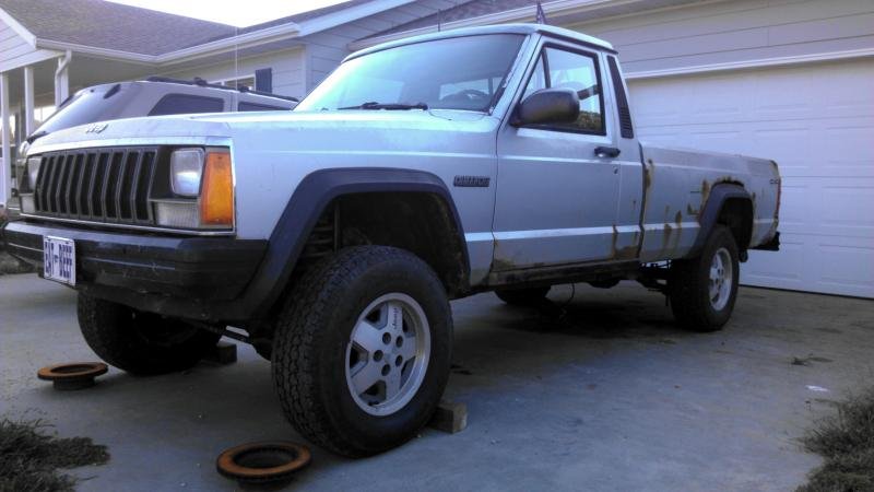

  20. Now she is back on the road. The truck drives much nicer now. The Chrysler style front brakes, albeit a poor design with the one piece knuckle, stop the truck much better than the AMC style brakes that were on it. Plus it is nice to have more parts interchange with newer Jeeps. Before the front end rebuild it felt like a squishy couch swaying down the road (according to my wife), even with the swaybar connected. Now it hugs the road like a Miata....ok maybe not, but the overall handling is much improved. The TJ 3" coils actually lifted the front of the truck 3", not the 2" that I was anticipating. This is probably due to the springs being stiffer for a heavier 6 cylinder. I am not complaining since it eliminated the forward rake. As you can see in the picture the stock trackbar is too short now, so the axle is sitting further to the driver side. I will install a used RE1600 trackbar when the new frame side end arrives.

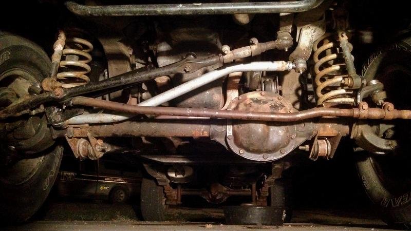

  21. Now that the summer heat has left Kansas, I decided to start on the front axle project so I can get a new set of AT3's mounted before winter hits. Non disco D30 gone through. - New Spicer Ball Joints - New Napa Unit Bearings - New Moog UCA bushings in housing - Replaced calipers, rotors and pads with lightly used parts from TJ - New Dorman Chevy 1500 brake hoses (these are much nicer than the YJ hoses) - Used 3" TJ lift springs The front end came apart real easy. I managed to get the new axle under the truck, but ran out of daylight while fighting with the driver side hard brake line. If the rain holds off, I should get it buttoned up in a few hours this weekend. I have found an 8.8, 4.10, limited slip, disc brakes for $200. If it is still available next week, I am going to try and pick it up.
