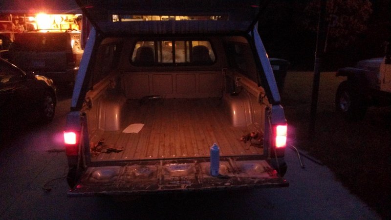

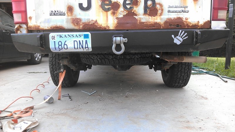

  21. It is official. The rusty truck is headed to Colorado for some scenic wheeling. I hope the stars align correctly and the Renix TBI system runs well at elevation and the 182k mile 2.5 doesn't hate me too much for it. In order to better prepare the truck, I stopped by my tire guy and picked up another 265/75r15 AT3 for the spare. These tires are about the same as a 31x10.5 so I suspected it would fit under the bed. The spare tire winch on this truck had failed before I acquired it. Not knowing if I would like the tire under the bed, I fabbed a mount out of some threaded rod, scrap steel and a little heat. The tire is flat against the frame, yet it seems to hang pretty low. I will see if the location needs reworked after my trip. I then attached the interior light for the topper to the previous owners power supply. Apparently they tapped power from the driver side tail light, but the light still works! I also discovered I probably have a corrosion/ground issue in the passenger side tail light....
