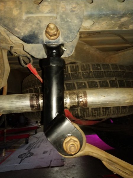

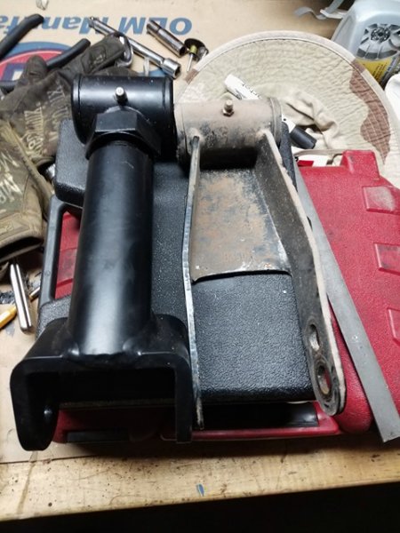

Had some motivation and a death wish today (apparently I don't learn even from major injuries). Just have to torque them down and grease. Needed to get measurements so I can order front springs next month and ditch the spacers. -
