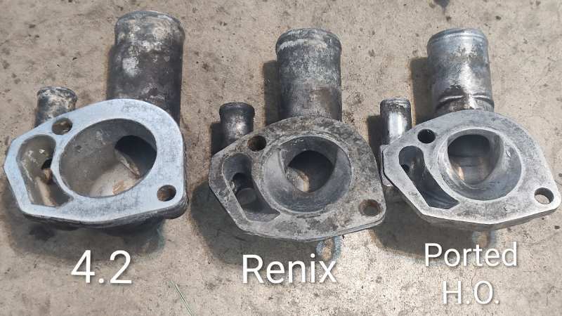

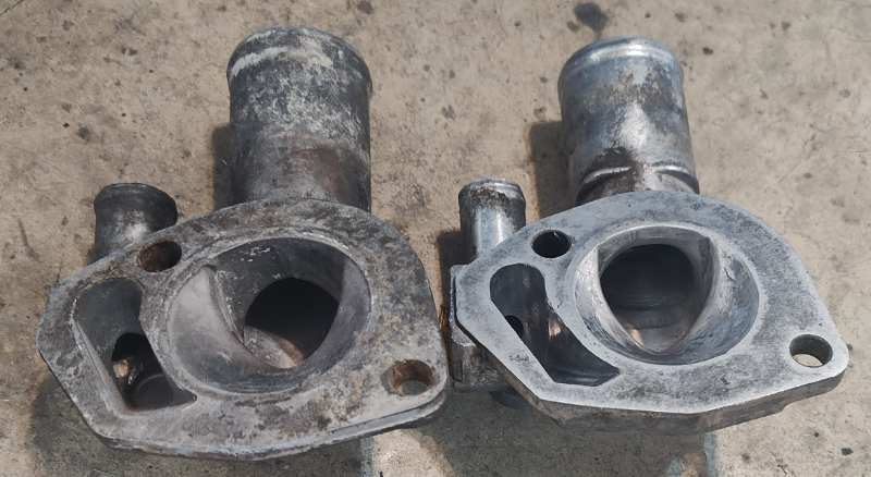

Eagle_SX4 Posted 2 hours ago Posted 2 hours ago If the Renix radiator mounted temperature switch fails the e-fan won't turn on leading to overheating issues. I installed a 200 degree temp switch into a H.O. thermostat housing that I ported and the fan comes on more but I don't have to worry about overheating issues now. If I recall the Renix temp switch is set at about 215 degrees, but I think that is too high. Your fans should be on before you start to overheat. I would like to get a newer e-fan with the 9 or 10 blade design but I haven't come across one in the junkyard yet. The thermostat housing is restricted and can be ported to allow better flow through it. I only noticed when I swapped my 4.2 thermostat housing for a H.O. housing. The housing was closed off to prevent the thermostat from being install backwards but it severely shrank the port size. The Renix and H.O. housings are the same other than the port for the temp sensor.

ghetdjc320 Posted 1 hour ago Author Posted 1 hour ago 1 hour ago, Eagle_SX4 said: If the Renix radiator mounted temperature switch fails the e-fan won't turn on leading to overheating issues. I installed a 200 degree temp switch into a H.O. thermostat housing that I ported and the fan comes on more but I don't have to worry about overheating issues now. If I recall the Renix temp switch is set at about 215 degrees, but I think that is too high. Your fans should be on before you start to overheat. I would like to get a newer e-fan with the 9 or 10 blade design but I haven't come across one in the junkyard yet. The thermostat housing is restricted and can be ported to allow better flow through it. I only noticed when I swapped my 4.2 thermostat housing for a H.O. housing. The housing was closed off to prevent the thermostat from being install backwards but it severely shrank the port size. The Renix and H.O. housings are the same other than the port for the temp sensor. Added the renix temp sensor issue to the list. I’ve been curious about the ported HO mod. I’ve heard two lines of thought on this, one is that the restriction assists in cooling by slowing the coolant flow a bit out of the block to aid in heat transfer. The other is that it’s for thermostat orientation as you mentioned. I know when I swapped to a high flow pump and the high flow housing with a still stock size radiator, I felt the water was moving to fast to effectively transfer the heat.
