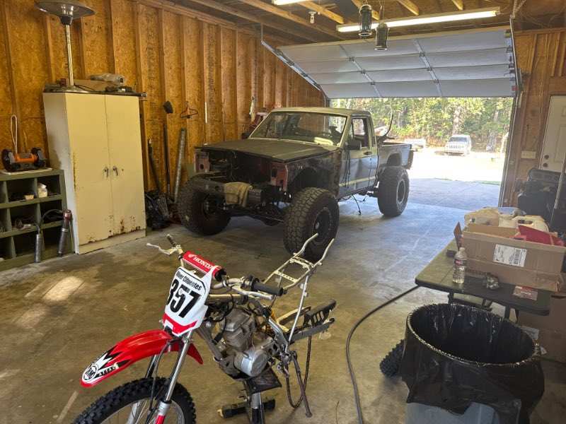

Haven’t worked on the truck much, other than getting it into its new home! 70x30 home workshop….upgrade!! also got my other pickup trucks, the donor Comanche, and the Tesla all squared away. there’s also a two car garage on the new house and an attached workshop on the 70x30 workshop lol

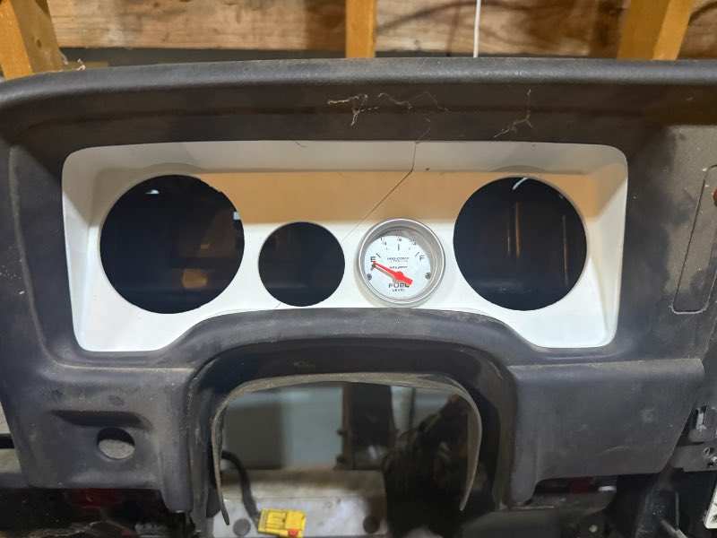

It my little gauge project wrapped up for the time being. Undecided if I'm going to use all gauges, or some form of digital gauge system. But either way I’ve got the geometry nailed down on the fitment and mounting, adjusting the inside contents is easy to finish later. The white plastic is just cheap prototyping stuff.

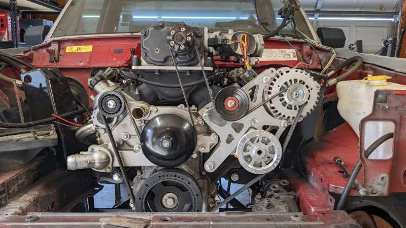

Probably the same kit I went with from ICT. If so, the power steering pulley will be too close to the fitting on the steering gearbox. Dirty Dingo makes a smaller pulleys that works great. Also the OEM steering reservoir will need some creative mounting, I flattened the bracket and squeezed it in the same area just rotated. This photo is old and has different belt routing, but you see what I mean about the steering pulley.

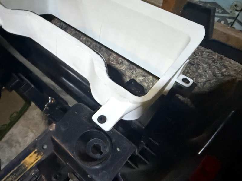

Its too hot to be working outside, so I am thinking ahead at some of the luxury items I want to do. Starting with the gauges/ECU....I don't want to run two ECU's and two harnesses to retain the jeep gauges. So I decided if I am doing custom gauges, I want to solve a few issues with one elegant solution. here's my new music, gauges, navigation, and telemetry device all in one, thanks to an old iphone lying in a random drawer in the house lol. The only two things the ECU won't be able to give readouts on is the fuel gauge and oil pressure, hence the two smaller gauges outside the cluster. This will drop in the 97+ dash and fit like factory, thanks to a scan from @boxyjeep

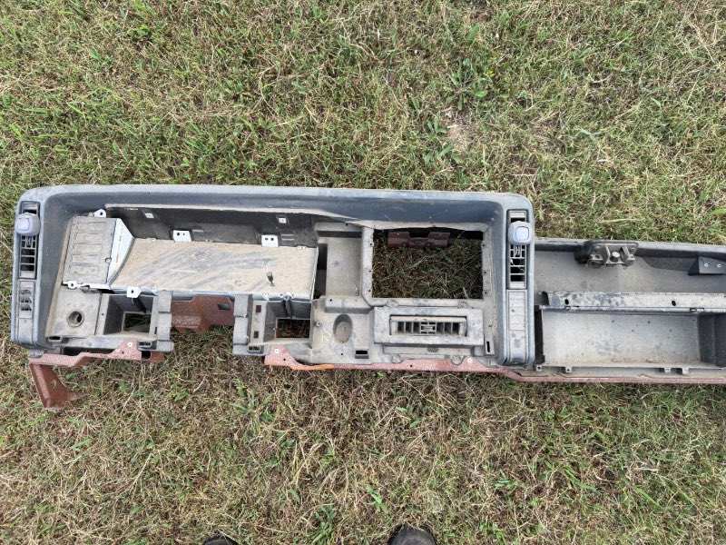

The donor has finally landed at my house, I completely forgot how many unique parts I threw in the deal for my buddy. -Full Black & Gray 1998 Dash -Completely redone axles -Complete wiring harnesses from the 1998 XJ bumper to bumper -2001 XJ ECU (very important for using stock gauges) -1998+ XJ Manual pedal assembly -1998 XJ Brake booster/Master -Most of the Comanche specific interior pieces -NP242 shifter assembly I'm sure there is more that I'm missing but those are most of the cool parts. I'm probably not going to use all of it. Ill post the not needed parts for sale.

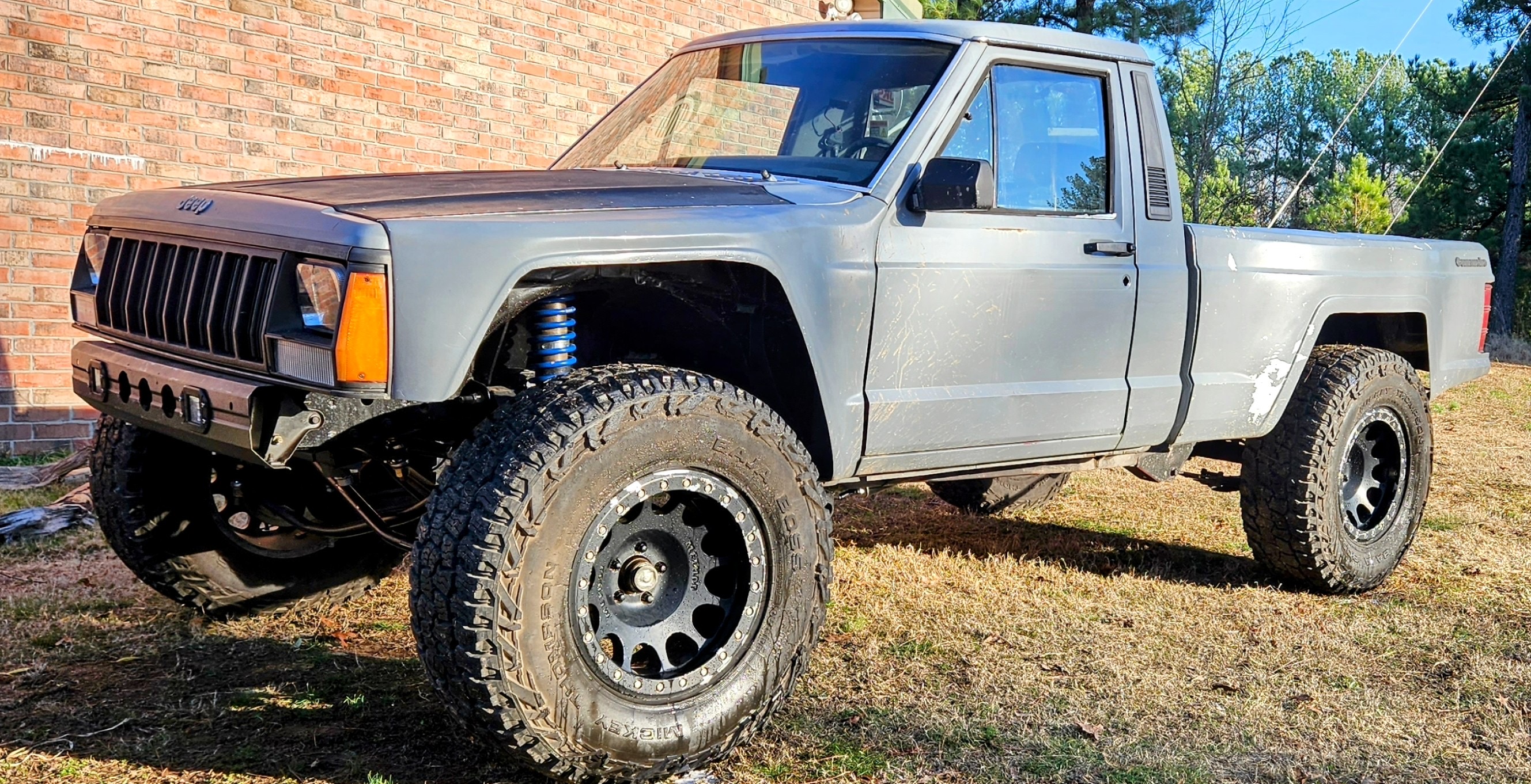

Alright, its been 2 months, and I can't bring myself to take a saw to this truck anymore. I don't regret what I have built it into, but I am also not happy with it. Long story short, I think the only way I will get the most use out of this truck is to tone it back. Its so un-fun/radical, scary, and expensive to drive as it has been. Thats needs to change so I can just get back to simply enjoying the truck again. I have a plan in mind, but I don't want to divulge all the details until its more for sure and I'm actually moving forward with it. For now I am just going to drop this photo of what I think I want to go for...and work on clearing the projects out of my shop so I can prepare to get back onto the MJ. Ill pop back in to update in the next month or so when the plan hopefully starts coming together.
