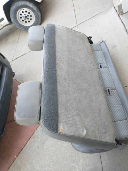

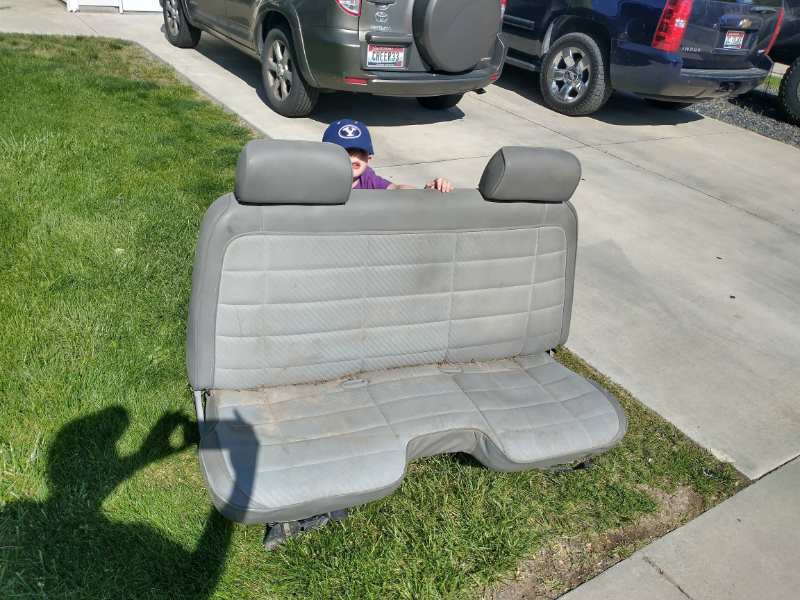

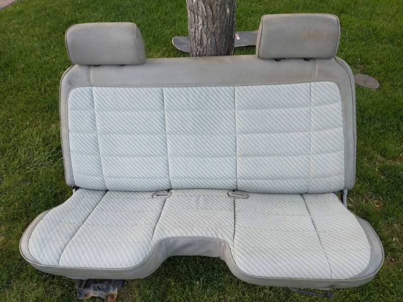

JZLAJeep Posted May 9 Author Posted May 9 Saw the bench for the first time when picking it up this morning. To my great surprise, the bench has headrests! Need to clean it up...
Salvagedcircuit Posted May 11 Posted May 11 On 5/9/2026 at 5:24 PM, JZLAJeep said: Saw the bench for the first time when picking it up this morning. To my great surprise, the bench has headrests! Need to clean it up... If you ever take it apart / remove the cover to clean it, I'd Love to see how the headrests were implemented. I wonder if there was a custom welded in bracket in the back. I bet its covered in foam though. It would be neat to see though. The headrest bench seats are so dang rare
JZLAJeep Posted May 11 Author Posted May 11 46 minutes ago, Salvagedcircuit said: If you ever take it apart / remove the cover to clean it, I'd Love to see how the headrests were implemented. I wonder if there was a custom welded in bracket in the back. I bet its covered in foam though. It would be neat to see though. The headrest bench seats are so dang rare Like I said, I was shocked when I picked it up! The upholstery looks a lot better after a thorough scrubbing and drying in the sun today. Have more scrubbing to do on the vinyl.
eaglescout526 Posted May 11 Posted May 11 51 minutes ago, Salvagedcircuit said: If you ever take it apart / remove the cover to clean it, I'd Love to see how the headrests were implemented. I wonder if there was a custom welded in bracket in the back. I bet its covered in foam though. It would be neat to see though. The headrest bench seats are so dang rare I think they’re put on the same way the buckets have them. With that little shaped bracket that fit the plastic adjuster. Honestly it probably could be done with a bench seat that doesn’t have the head rests presently.

JZLAJeep Posted May 14 Author Posted May 14 Should have foreseen this, but didn't. The lightweight fabric on the back of the bench will be too flimsy to hold up to passengers in the back seat. The fact that it's there at all is a small miracle (the fabric is missing from the back of our MJ's bench). Will need to figure out something different. A cover is the easy solution. Removing the cover and sewing in a more durable material is a better solution. But hate to put a lot of money into a bench that was free in a configuration that I may or may not want to ultimately keep. Will probably see if the concept works first and then work out the back covering if we decide to keep it.
Pete M Posted May 15 Posted May 15 it's pretty easy to unbolt the back. I'd install it and see if I like it first.
JZLAJeep Posted May 15 Author Posted May 15 13 hours ago, Pete M said: I'd install it and see if I like it first. Agreed
Warthog Posted May 15 Posted May 15 On 5/14/2026 at 2:16 PM, JZLAJeep said: Should have foreseen this, but didn't. The lightweight fabric on the back of the bench will be too flimsy to hold up to passengers in the back seat. The fact that it's there at all is a small miracle (the fabric is missing from the back of our MJ's bench). Will need to figure out something different. A cover is the easy solution. Removing the cover and sewing in a more durable material is a better solution. But hate to put a lot of money into a bench that was free in a configuration that I may or may not want to ultimately keep. Will probably see if the concept works first and then work out the back covering if we decide to keep it. Get some paneling and cut you a template, cover in carpet or vinyl etc, I use tread bright aluminum on everything and paint to match. You can glue or Velcro or mate a metal strip to the inner frame via counter sunk screws and screw the new back to that. A little door trim around the edges to clean up the looks. You can get that stuff in rolls on Amazon cheap. If you can’t find the right color get as light as possible and get some duplicolor vinyl spray and paint to match. Awesome idea by tye way!! Bench in a cherokee? I would in a second! But I can’t even find a decent bench for my Comanche let alone another for m cherokee! If I still had the ebrake you could have it. Went buckets for lack of choice. I’ll look around, don’t remember chunkin it but don’t remember keepin it either.
