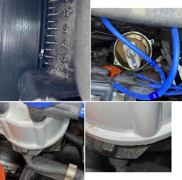

Timing is controlled by the ECU. Indexing is where the tip of the rotor is in relation to the distributor tower terminal. Crossfire, weak spark are some of the symptoms. Try and determine if your setup (index) is like that as shown in the photos. No need to cut tabs or remove distributor. Just check indexing.
That timing mark on the crank (0°) can show up on either TDC for Cyl#1 or Cyl#6, depends on where the camshaft (valvetrain timing) is. Need to determine which one. Tip 12 tells how to do that.
Unfortunately that 12 is the 12 of 12&13 I don't believe I understand well enough to do. :(.  I'll go do some youtube searching and maybe find some examples.  Pretty sure I can't get my finger or thumb down in the plug hole, definitely not my thumb, while at the same time turn the engine at the balancer bolt with the other hand!
Yea. Plugging the hole and rotating the engine needs two people. Let see if I can make this even more confusing. Instead of Cyl#1 plug, remove Cyl#4's plug (easier to get to). Then the next time the timing mark shows up, you're on TDC compression stroke Cyl#1.
If the timing mark is the mark on the balancer, wouldn't the "next time the timing mark shows up", which I am only guessing mean shows up lined up with the line(s) on the block, be visible just the same with or without the plug in?  Not sure what difference the plug being in or out is on if the timing marks show up, so yeah, more confusing bar reached :laugh:.  I guess the day all this timing stuff was taught during my Advanced Shade Tree Mechanic class I must have been out.  Either way it has hit mid 90s out in my driveway so I am done for the day out there, I'm too old to work out in the sun!  I'll start again in the morning.
Plug removed, thumb over the hole, only tells you when that cylinder is on the compression stoke. Time to fire (ECU) the plug (distributor) for that cylinder.
