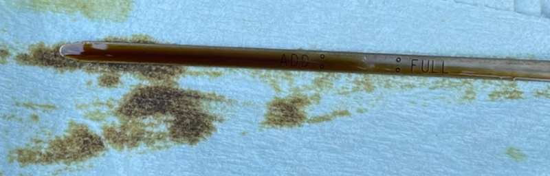

1) Pull the oil dipstick and see how it smells. If it smells like raw fuel and the oil feels thin, we'll want to know that.

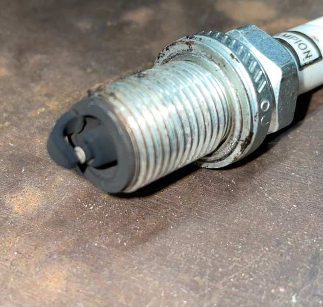

2) Pull the plugs and see if any look/ smell different from the rest. "Good" will have a white to light tan ceramic insulator, light deposit on the ground strap, possibly with a slight color change about 1/2 way up, very light and even black around the end where the threads are and clean center electrode. Some evidence of age-related oil deposits may be expected and not that big of a deal at the moment.

I have not tried to track down a pressure tester yet but I did the quickest one, pulled the dipstick.  I don't particularly smell anything from it.  It is slippery but could it be "a little thinner?", I can't really judge that.  If I hold the dipstick up horizontally with the wide side vertical the fluid slowly begins to accumulate more on the bottom, nothing drips off, that's about as much as I can say about it.
It's starting to rain but I pulled the easiest to get to plug before getting wet.  I am thinking the experts can maybe make something out of just this one to start with and I'll go further after the rain.  I looked in my records and I put in new plugs, rotor, dist and wires back in Jan and at that time Jeep was very happy.  I'll note in case it is useful that this plug was not very tight.  It wasn't finger only removal loose, but it took almost no effort to "break" it loose.

I cleaned that plug up pretty good.  Took out the next one and it looked exactly the same.  My plan was to take all of them out one at a time, note if any looked different, clean each one up as good as I could and put them back it, and see if anything changes.  Unfortunately the 3rd one I removed the ceramic top broke, so that plan doesn't really work anymore so I'll be getting some new plugs.  I am expecting 1 of 2 things to happen, assuming they all look the same:
1.  The black plugs were blacken by the driving since the time of "the incident", and just maybe all the things fixed at this point will result in running well once all the black plugs are replaced with clean ones.  This will be the lucky  outcome.
2.  Nothing will change and the problem remains as it was before this exercise and I'll still be down.

Forgot to mention that the 3 I removed so far looked exactly the same.
If the oil was getting heavily fuel contaminated, the dipstick would stink of raw gas. Sounds like you're ok there, so you likely don't have an 'internal' fuel leak making it dangerously rich. However, I agree with Porquer that the plugs show very rich/ sooty, with the ceramic insulator completely blackened. I'd still go ahead and see what your fuel pressure is with the ballast resistor both hooked up and bypassed, it's just good to know.
Bad news is you're definitely over-fueling, likely something with an exhaust leak near the O2 sensor as stated previously. The increased loudness, even after a muffler change, indicates either your exhaust manifold is indeed cracked where you can't see it, or possibly the donut gasket to the downpipe is blown.

Thanks @Gojira94, @Porquer.  Since I broke a plug I'll go ahead and replace it, there's not a lot of choice on that one.  For the others, a pic of one cleaned up is below.  I'm thinking cleaning and reinstall is good enough at least for now, the plugs were all new in Jan.
