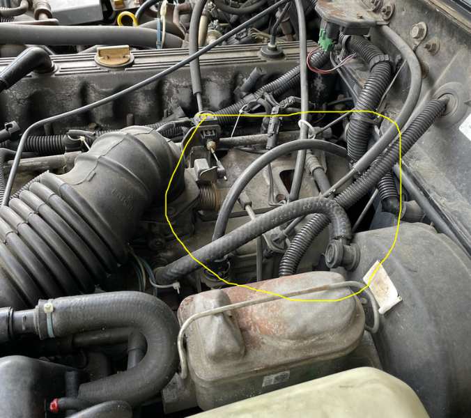

Looking around I don't see any hose that came loose.  There's nothing dripping anywhere.  While I as in the parking lot I thought I could see a very tiny amount of smoke in the vicinity of the yellow area in the pic below, very faint.  And now at home I don't see this at all.

How does the MAP sensor to throttle body vac line look? If you haven't done cruiser's fix to install a threaded tap then the vac connection is a bit dicey
12 minutes ago, AnotherOldJeepGuy said:
I have looked, and I will look again, but how would an acceleration break a hose???
About the only way I can think of would be a combination of an old, brittle hose and the acceleration causing the engine the engine to torque over farther and breaking the hose. Its a stretch though.
Since the vac line just kind of sticks into the hole in the throttle body, enough vibrations and enough bad luck can cause it to come loose and leak vacuum or come out entirely. The former and the latter have both personally happened to me. Worth a check

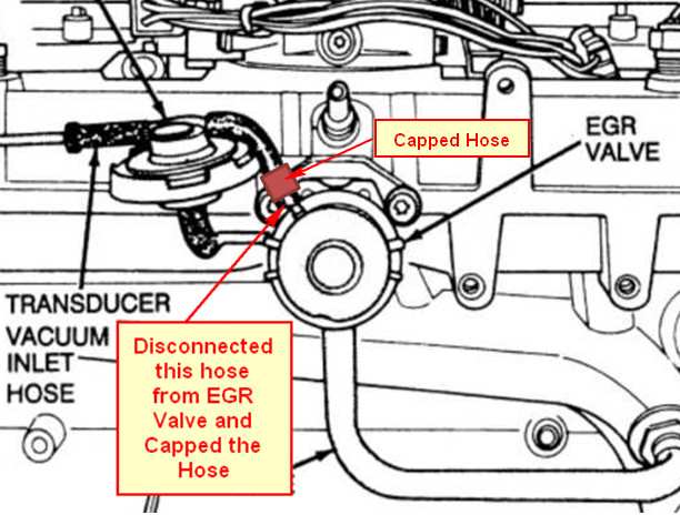

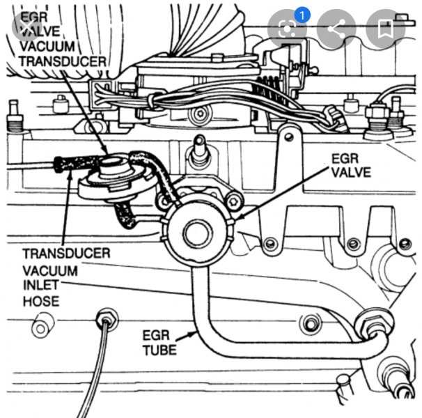

So is the truck still running rough right now? Also how do the EGR vac lines look? You may have done this already but if it’s still running poorly, you can try to find the source with brake cleaner
Yes it will start and still cycles from very rough to less rough but for the moment it can manage to stay running.  I watched what I think is the EGR valve and I see the little shaft moving with the RPMs and the hose looks the same as they normally do as best I can tell (I have not removed them).  I tried spraying [edit: with water]where the manifold connects, months back I did have to tighten them, but since the engine is already cycling I can't tell if the water is doing anything, but I don't think it is.  I'm going to try checking them for tightness again after the engine cools off.
