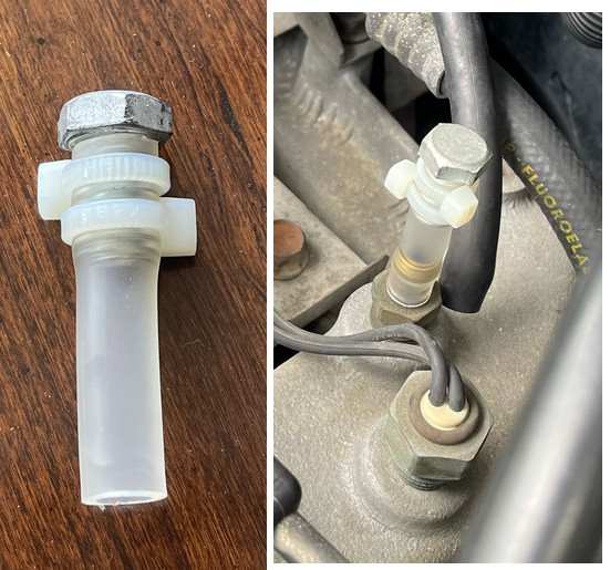

AnotherOldJeepGuy Posted May 29 Author Posted May 29 I made the "plug" below. The bolt is in very tight to start then snugged further with 2 tie wraps. I don't know that this was a 100% plug but it should be very close to it. (I can redo it with come E6000 glue if it doesn't look like it is OK as is). With this one the vacuum port (but before reading your post about resetting by disconnecting the battery) I saw no change. Sluggish response to throttle, running choppy, and at least once when I got the RPMs up and let go I got a small backfire (similar to the one I posted a video of a page back). I'll go disconnected the battery and repeat the test.

Gojira94 Posted May 30 Posted May 30 Fuel pressure is fine, not an issue. A piece of hose and a bolt is a time-honored method of plugging a vacuum port lol. I'd say leave that in place for now while troubleshooting continues. There are plenty of places for vacuum lines to crack near the vacuum tank and the check valves may not be healthy enough to hold vacuum. Once the issue is solved, you'll want to investigate and patch up any other other vacuum line breaks, and see if the vacuum tank still holds. Maybe even get cruise control back... Meantime, I think you're on the right track to try to confirm a cracked exhaust manifold. And the O2 sensor may be dead or contributing to the issue if it's commanding more fuel if it's seeing what it thinks is a lean condition from cracked manifold. When you turn the key on prior to engine start, do you see the 'Check Engine' lamp light up during the lamp check? I wonder if the bulb might be burned out and would otherwise be illuminated. I'm willing to loan you my REM, I don't have any immediate need for it. PM me with info and I'll mail it to you. I'm still concerned about verifying spark/ spark timing. More so with the distributor indexing than anything else. The coil and module are working, at least. The coil can be tested for primary and secondary resistance easily enough with a meter while the module would require a DRB II.
