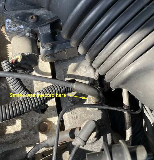

I just did soap test #2, I suds-ed up all along the top of the area where the manifolds connect and again saw no signs of any bubbles being blown, or soap being sucked in, and also no sign of RPM changes with the soap and then as I rinsed it off.  This is not too surprising since the water testing has already proven to not show anything, but it was another place to try the soap that was easy enough to get to.  Now I need to let it completely cool again and see if there are other places I can soap up and try again.  I am not loosing track that everything was great until the "maneuver incident" so although I cannot yet find any crack, a physical issue still seems more likely (at least to me) rather than some control that failed coincidentally at that same instant.

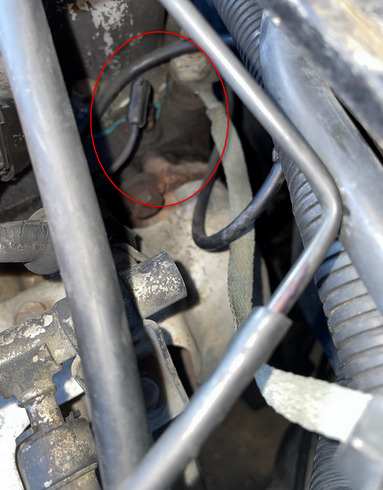

More low-hanging fruit - clean the heck out of the grounds at the oil dipstick brace mounting bolt (G105). That's where the injectors all get ground. All 6 injectors' grounds are spliced together and go to that ground point. It's also possible there's some wire chafing in the injector section of the harness along the driver's side of the valve cover.

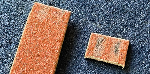

Pulled 3 lugs at the block ground point, plus the primary ground cable.  The primary ground cable is relatively new and still looked clean, the other three were not terrible but for sure have been improved now.  I scuffed them clean with sandpaper, also the point of contact with the block.  Then gave them a bath of contact cleaner.  After the cleaner dried I put it back together.
