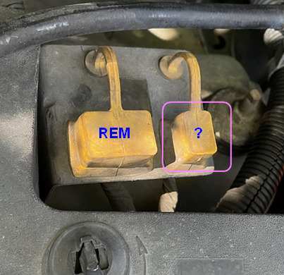

AnotherOldJeepGuy Posted July 1 Author Posted July 1 Three more days with successful trips, so far so good. Can't really guess well how may key starts since I put the EGR hose back in place, probably not 40 yet, but maybe half? So another question to toss in the thread while the "Test it to 40" plan is in play. What is the second connection used for that's to the right of where the REM connects?
AnotherOldJeepGuy Posted July 2 Author Posted July 2 1 hour ago, llhat said: Yikes! With my computer glasses on high I can just barely make out those letters! But good enough to squelch my curiosity.
MagicJames Posted July 2 Posted July 2 6 hours ago, AnotherOldJeepGuy said: Three more days with successful trips, so far so good. Can't really guess well how may key starts since I put the EGR hose back in place, probably not 40 yet, but maybe half? So another question to toss in the thread while the "Test it to 40" plan is in play. What is the second connection used for that's to the right of where the REM connects? I always thought the second connector was for ABS diagnostics
llhat Posted July 2 Posted July 2 11 hours ago, AnotherOldJeepGuy said: Yikes! With my computer glasses on high I can just barely make out those letters! But good enough to squelch my curiosity. i believe a jpeg, save to computer and enlarge.. I see OHM has posted a link also thanks.
