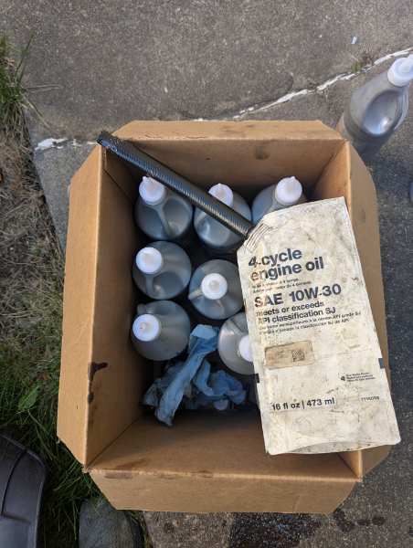

speeding_infraction Posted April 18, 2025 Share Posted April 18, 2025 I'm sure everyone has done this at least once Link to comment Share on other sites More sharing options...

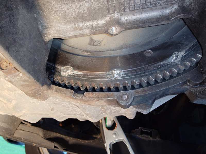

pizzaman09 Posted July 10, 2025 Share Posted July 10, 2025 I chased difficult to start issues on my 09 Honda Civic Si for three months. It got to the point where the only way it would start is by bump starting it. After throwing the parts canon at it, I discovered the ring gear on the starter was completely loose and spun freely around the flywheel. A mig welder and about 15 spot welds has fixed that problem. Thank goodness it has an inspection cover. Link to comment Share on other sites More sharing options...
