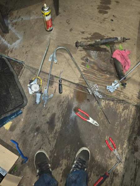

Manual window regulator repair
mbred0609 replied to coathanger37's topic in MJ Tech: DIY Projects and Write-Ups
I know its an old post but I'm glad I found it. I can confirm this works. I broke my cable today and found this post. I replaced a power window in one of my 99s about 9 months ago and the regulator was still in the scrap pile. Threaded out the snake and rethreaded the 99 snake back in. Picture of the old snake, the 99 regulator, and the 99 snake now in the comanche regulator. Thank you for posting this. Matt -
