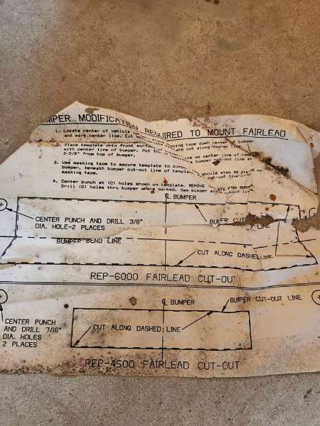

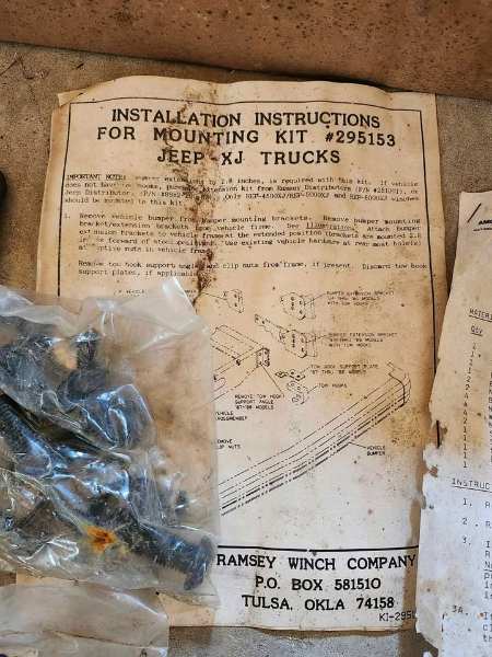

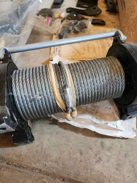

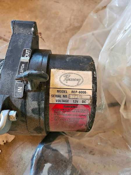

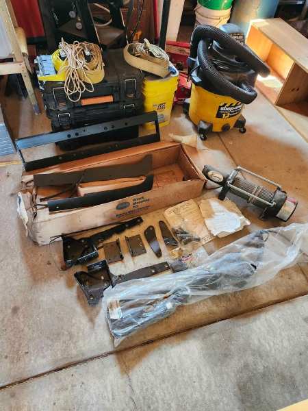

Gojira94 Posted September 17, 2025 Share Posted September 17, 2025 Thread necro, but I saw this (sold) kit on FB Marketplace from a year ago (2024). Only pics of actual full kit I've ever seen. Link to comment Share on other sites More sharing options...

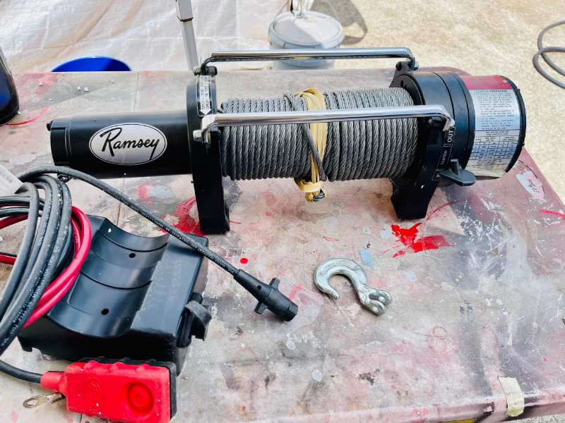

Gojira94 Posted September 17, 2025 Share Posted September 17, 2025 Another reference pic of the winch assembly itself. The stuff at the left foreground is associated with a Jurassic Park Jeep setup, so ignore. Link to comment Share on other sites More sharing options...

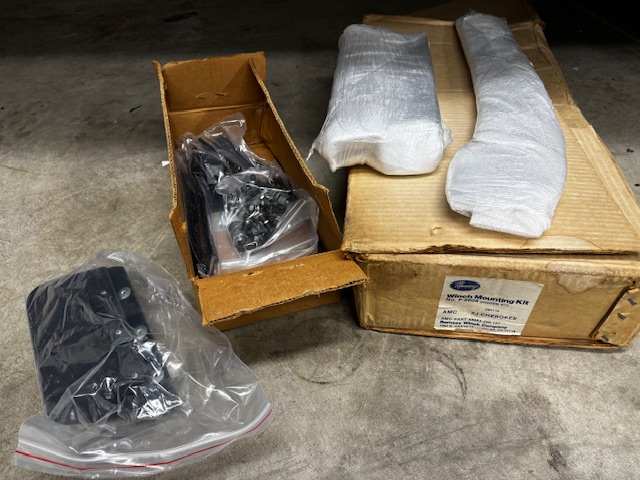

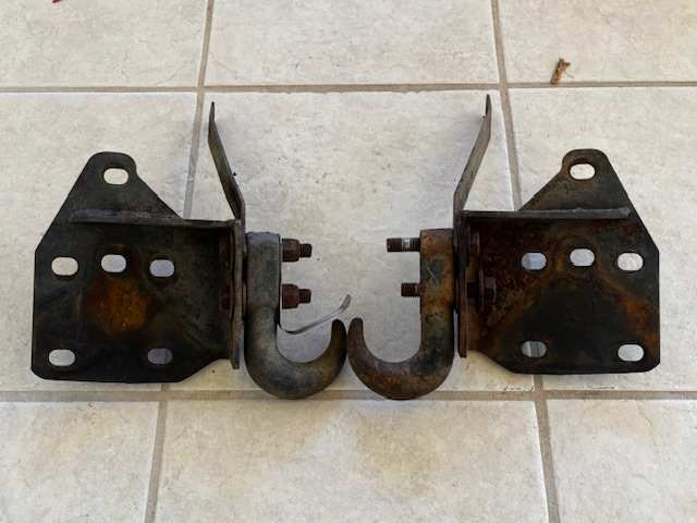

Gjeep Posted September 17, 2025 Share Posted September 17, 2025 I recently purchased/ picked up (this week) a NOS XJ Ramsey kit in So Cal. No winch. Bracket kit only. Also this morning I stripped an 86 XJ Chief that also had the factory Ramsey hidden winch setup (also no winch) and interestingly enough the tie-in tow hook brackets were stubby, first gen style. Didn't grab the crossmember brackets as completely different 2.8L to 4.0L years. '86 XJ tow hook brackets used with hidden winch. Actually has 6 bolts per side where as 'newer' set up had only 3 per side, but had the through-the-frame bolt each side further back. NOS 'second' gen Ramsey mounting kit for 4.0L years. Link to comment Share on other sites More sharing options...
