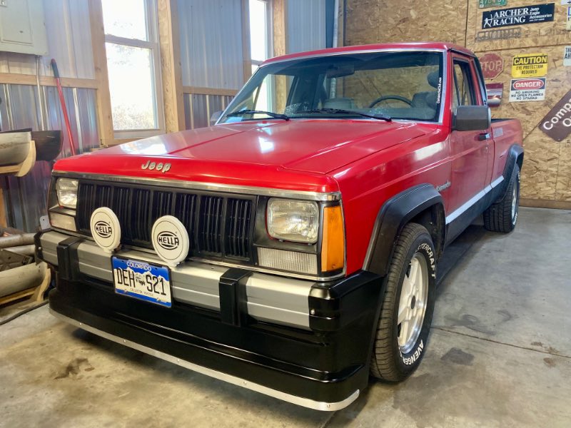

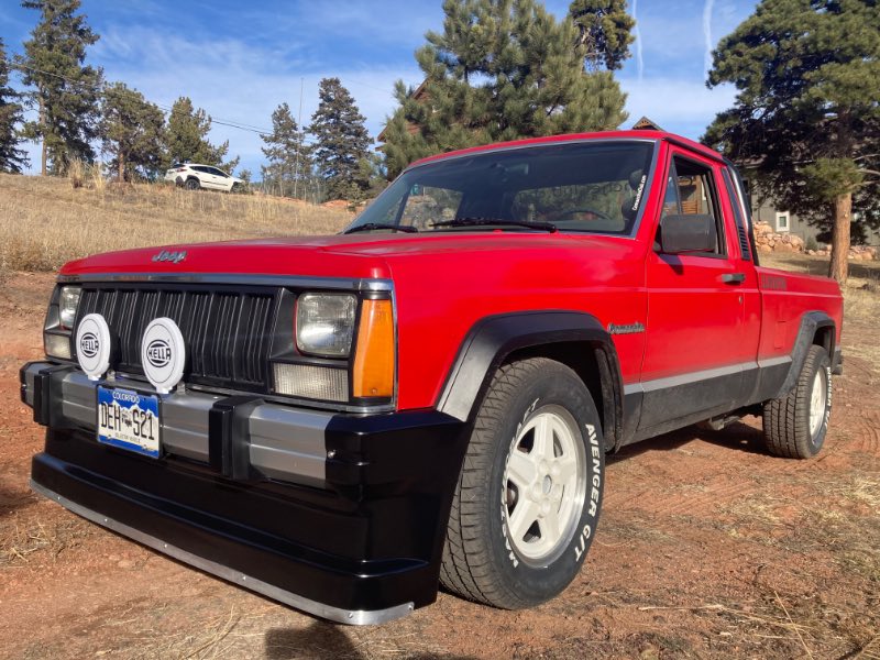

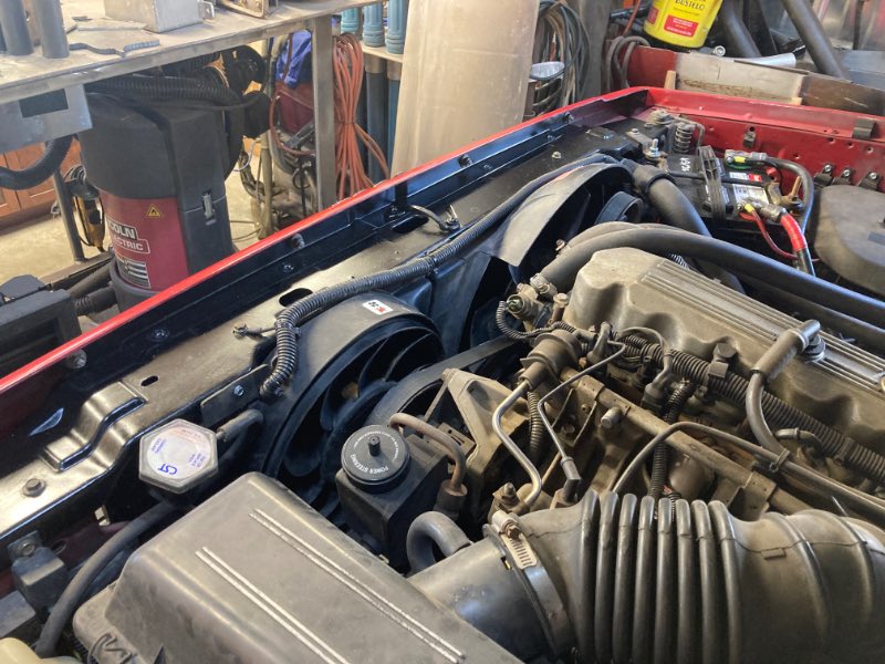

I finally got around to getting pictures of my red truck with the engine back in it. I've been putting up a new garage in my yard and times have been tight. The 4.6L runs awesome and has tons of power under the skinny pedal!
Picture of the fans also... I decided to keep the mechanical fan for now, but these little guys reduce coolant temps by about 20 degrees! They run off of an electric thermostat or off of a switch.
Also the only rust on the whole body (which is amazing for being a MN truck).

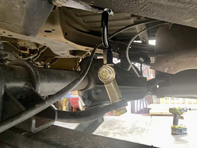

Also got a Chrysler 8.25 for the 1989. It came out of a 4 cylinder Cherokee so it's got 4.10 gears. Ebay supplied the matching gears for the front... which STILL has camber issues.
I did however figure out my awfull handling of the front (besides the camber). The upper joint of the track bar is completely toast.
