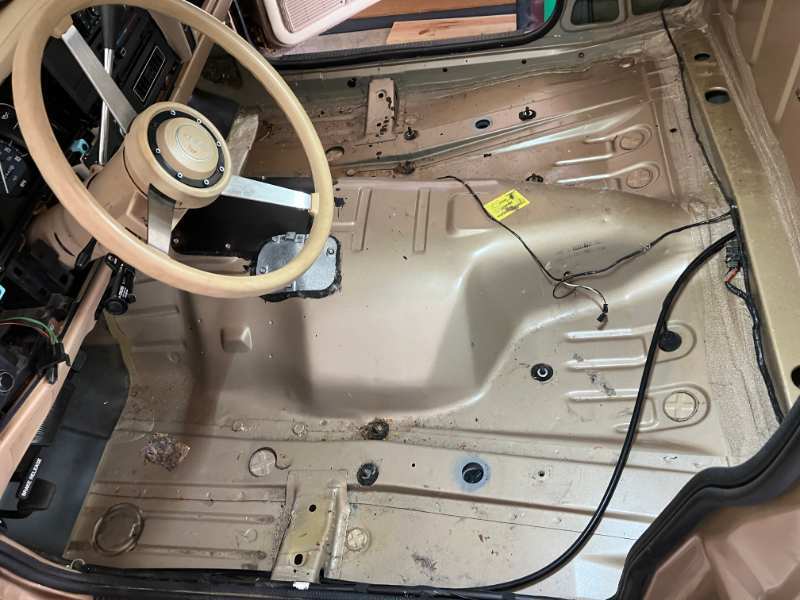

jodawill Posted Saturday at 07:53 PM Posted Saturday at 07:53 PM I finally got around to pulling up the carpet to check for rust. It looks pretty good. Now that I have the carpet out, I have two questions: 1) What else should I do while this is taken apart? 2) What should I do about sound dampening? I've seen concerns that Dynamat may trap moisture on the floor. What should I do?
The86manche Posted Saturday at 08:34 PM Posted Saturday at 08:34 PM Scuff it and seal it with some enamel or other tough and comparable product. Spray some rust preventative, like cavity wax in those floor braces too and then you'd be find to put some sound deadening in if you wanted.
watchamakalit Posted Sunday at 10:17 AM Posted Sunday at 10:17 AM Wow. Cleanest floor I think I have ever seen......
ghetdjc320 Posted Sunday at 01:14 PM Posted Sunday at 01:14 PM That is one clean floor! I’d check the seam sealer and identify any possible leaks. If it’s all good, do as recommended above. On my last build after I removed and re seam sealed the cab, I por 15d it then raptor lined it. It’s worked great so far. And I did end up using dynapad on the floor with excellent results. I just don’t recommend the mass backed carpet. For me, it started to crumble and our gas horribly after 3 months.

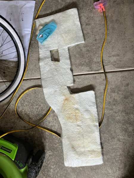

jodawill Posted Sunday at 04:34 PM Author Posted Sunday at 04:34 PM Here's one of those white pads I mentioned. I'm not sure whether these are original. It seems odd that they're in bags.

Pete M Posted Sunday at 06:16 PM Posted Sunday at 06:16 PM yes, those are factory. plenty of weird things in an MJ. lol.
fiatslug87 Posted Sunday at 07:36 PM Posted Sunday at 07:36 PM 3 hours ago, jodawill said: Here's one of those white pads I mentioned. I'm not sure whether these are original. It seems odd that they're in bags. Those are from the factory.

The86manche Posted Sunday at 10:53 PM Posted Sunday at 10:53 PM 6 hours ago, jodawill said: When you say enamel, do you mean something like Rust-oleum clear enamel? I'd like to keep the original gold paint if I can. There's a very small amount of rust around a few bolts that I need to address, but I don't want to spray a bunch of colored paint and ruin the original finish. (Yeah, I won't see it, but I can't stand the thought of ruining that factory finish floor.) I might just clean up that small bit of rust with a rotary tool and use a stencil to spray the rust converter only on those particular spots. You could use a clear enamel if you wanted. And if you didn't want to brush it on and have that brushed look you could grab a cheap harbor freight spray gun and reduce the enamel and spray it on for a smooth look.

Gojira94 Posted 43 minutes ago Posted 43 minutes ago For the sake of posterity and documentation, what's printed on that yellow label on the tunnel? Or is that just a business card lol?
