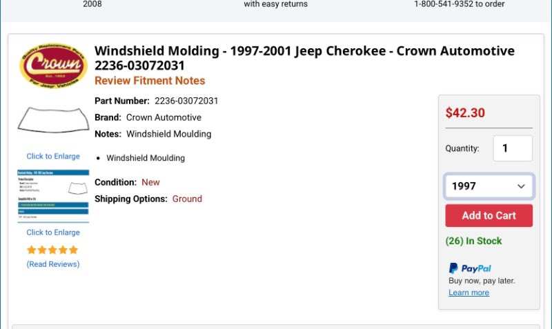

TheNerfsmith Posted July 29 Author Posted July 29 Do any of you guys have a part number for the rubber seal? I found an installer for the windshield and they want me to order the gasket/seal.
AZJeff Posted July 29 Posted July 29 4 hours ago, TheNerfsmith said: Do any of you guys have a part number for the rubber seal? I found an installer for the windshield and they want me to order the gasket/seal. It’s odd that your glass guy does not have a line on that rubber surround, given that the seal often becomes permanently bonded to the glass during installation and must be replaced when new glass is installed. A clarification here: that rubber piece is NOT a gasket or seal. Its presence (or lack thereof) will play NO PART in making the glass-to-body joint waterproof. That rubber piece is there strictly to fill the gap between the edge of the glass and the opening in the body shell.
ghetdjc320 Posted July 29 Posted July 29 I used satellite. Just told them it's a 97 Cherokee. No issues.
Pete M Posted July 29 Posted July 29 pretty sure that rubber trim comes free with the 97+ glass? I don't remember there being a price difference.
TheNerfsmith Posted August 4 Author Posted August 4 Update, I have the rubber moldings for the windshield, I found a company to do the glass which was the appointment this morning. I'm out of town and get a phone call that the tech needs the clips which hold the molding on, me not being knowledgeable enough I figured I'd ask you all if you know where to get them or if there exists another solution.
AZJeff Posted August 4 Posted August 4 14 minutes ago, TheNerfsmith said: Update, I have the rubber moldings for the windshield, I found a company to do the glass which was the appointment this morning. I'm out of town and get a phone call that the tech needs the clips which hold the molding on, me not being knowledgeable enough I figured I'd ask you all if you know where to get them or if there exists another solution. The clips are ONLY used on the windshield trim when using the bright metal trim pieces. If you are using the one-piece rubber surround trim, no clips are needed. i would be concerned that your glass installer doesn’t know what he is doing if he thinks he needs metal clips to install a windshield with the rubber surround.
TheNerfsmith Posted August 4 Author Posted August 4 9 minutes ago, AZJeff said: The clips are ONLY used on the windshield trim when using the bright metal trim pieces. If you are using the one-piece rubber surround trim, no clips are needed. i would be concerned that your glass installer doesn’t know what he is doing if he thinks he needs metal clips to install a windshield with the rubber surround. That's what I thought, unfortunately for me they are the only installer so I'll be sure to let them know what they need to do. This whole mess between 5 different glass companies on top of Safelite being fickle about the thing has been a massive headache.
TheNerfsmith Posted August 4 Author Posted August 4 9 minutes ago, TheNerfsmith said: That's what I thought, unfortunately for me they are the only installer so I'll be sure to let them know what they need to do. This whole mess between 5 different glass companies on top of Safelite being fickle about the thing has been a massive headache. Just so I have my head on straight, There is no difference between the windshield glass 86-01 The one piece rubber I got from Crown does not need any metal trim holding it on The windshield should be bonded with the molding with a urethane adhesive
