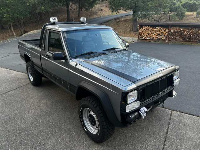

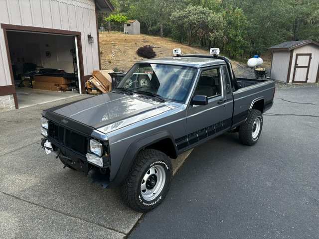

Gjeep Posted March 20, 2023 Author Share Posted March 20, 2023 Unbagged the Chief decals and am beyond thrilled Graphics Express provided extended lengths of the body/ bed stripes so owners can trim where they feel is best. The only way to go. It’s going to be challenging getting the areas that need a little more attention right, specifically – door to rockers, cab and rear bed corners. I want to jambs and gaps proper also. Decided I’m going to start with paper templates in those areas for sanity to get everything dialed then trimmed prior to application. A 6’ cutting mat, metal ruler, and plethora of new x-acto blades are on the way. Link to comment Share on other sites More sharing options...
Gjeep Posted March 22, 2023 Author Share Posted March 22, 2023 I decided to create graphic templates cut to size before trimming out the final. Three years ago I ordered several sets of gloss black graphics that I won’t be using, as matte black will match flares, etc better. These gloss black ones will be used as templates. Factory Chief graphics I learned didn’t wrap into the jamb areas of the door or bed gap; and the ‘top’ stripe of the main lower graphic panels are supposed to be centered in the sheet metals 45-degree angle lower body line. So I started trimming to size, driver side door graphic first. It took me all four driver side scrap door graphics to cut one out, 98% of how it should be. I still need to take a sliver off the rear most vertical line so it has the same gap/ paint reveal as the rest of the decals. I used paper to get the front and rear shape of the door correct and traced that on to the graphic before cutting/ test fitting to size. This panel took me close to 4 hours to get near dialed. Insane. Getting down to righting wrongs, it always bugged me how the factory handled the cab and bed corner on the Chief truck. They didn’t follow enough of the body shape and by doing so more paint was visible outside the graphic area than should have been. So, I cut how I felt it looked best, having more horizontal coverage. This one didn’t take nearly as long as the door – and the bed sides were God-sent by comparison. Simple lines, simple cuts. Step 1: Step 2: Step 3: Step 4: Finally got it: Will tackle the smaller band of stripes templates that are placed above these soon. Once I recover from these. And again, I realize I make it all harder than it needs to be. Jamb wrapped graphics would look just as good, but my crazy self prefers to lay these out in a way that I can sleep at night. Graphic Express and Phoenix Graphics do an amazing job on these. Couldn’t be building Chief’s 36 years later without them. Looks like a Chief is taking shape – and yes, there is a lower graphic panel that goes on the rocker. And here’s the inspiration behind it…from a Jeep calendar I got from Red Mistress. I can trace all the pain of this graphic cutting insanity back to him. 😊 Link to comment Share on other sites More sharing options...

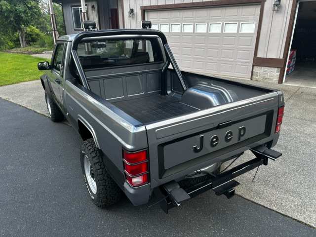

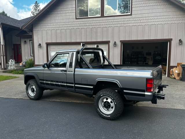

Gjeep Posted April 5, 2023 Author Share Posted April 5, 2023 Cut. Wasn’t near as bad as I thought it would be – had a good night rest, 5 hours with scissors/ blade and the graphic trimming is done. Sure, I see spots, am somewhat cross-eyed now and have a mild headache, but worth it. I only mis-cut the passenger cab corner (yes, I re-did it), and I’m ashamed to admit I botched a straight cut for the tailgate cross stripe (no idea how, it’s just measurement and straight cut. Re-cut a new). Finally, for peace of mind, I cut a second set of door ‘Chief’ graphics just in case I have issue when installing. Link to comment Share on other sites More sharing options...
Gjeep Posted April 6, 2023 Author Share Posted April 6, 2023 I decided it would be best to trim to size the upper set of stripes for the Chief graphics. Glad I did, as it took some time and was a bit more challenging than expected. Based on photos/ research, this graphics stack is slightly less tall than the what the factory offered. The taillight ‘stop’ is how I learned this. Not a bit deal as I just round-cut the third from bottom stripe versus a straight cut at the taillight. Link to comment Share on other sites More sharing options...
