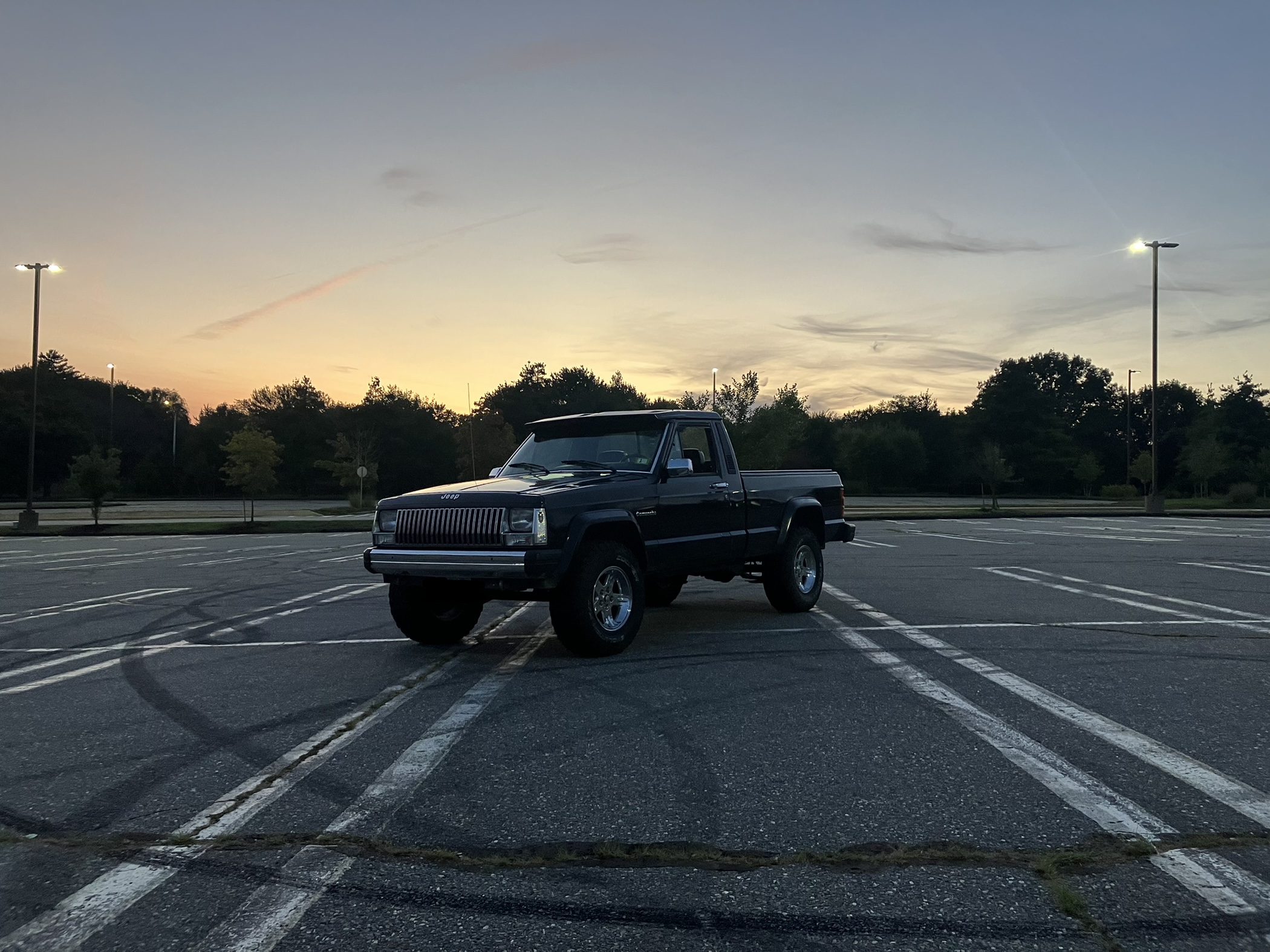

Hey guys, a couple weeks ago I was replacing my rear brake line and found my 02 sensor wires just dangling, turns out at some point the wiring on the sensor broke off of the sensor (explaining my sudden drop in fuel mileage and lack of power lately). Then I found all the conflicting information about the 02 sensors themselves, some say none available work(find JY one), some say they swear by the Bosch, and others say the Bosch don’t work at all and to go with the NTK, so just curious if any one else has ran into this problem and what your experiences and solutions have been TYIA Pic for attention
