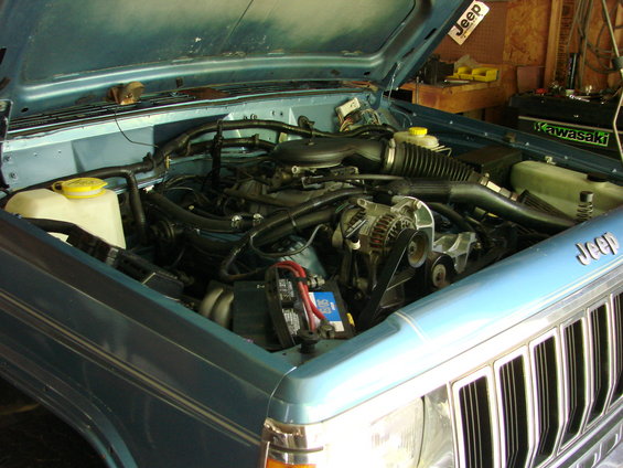

91MJdude Posted October 16, 2009 Share Posted October 16, 2009 ok well Ill upload some of the pics of the progress we made this weekend. here is where the wiring will lay. Tried to match the 4.0l routing. Completle dissasembled and cleaned the TB. Fuse block and Older style innerfender overflow bottle. Sorting out more wires.... Cut large hole for Transfer Case. :) 92+ washer bottle, and ECM mounted. also bolted down the valve covers and bent the dip stick tube for transmission to fit. May get locar flexible one later on. Link to comment Share on other sites More sharing options...

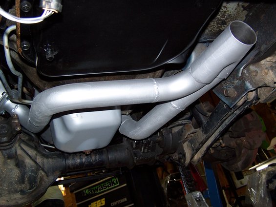

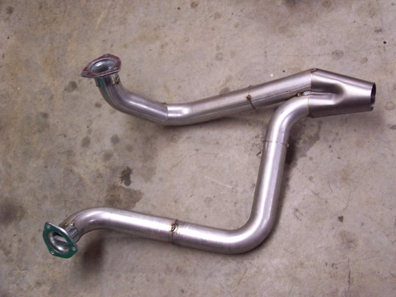

91MJdude Posted December 17, 2009 Share Posted December 17, 2009 It Runs! First time trying to crank it up, it fired right up and settled down to a nice loud idle with only a Y-Pipe made. Ignore the power steering, fluid was yucky and aerated Click here to watch video >>> http://www.supermotors.net/registry/media/772607 Link to comment Share on other sites More sharing options...

360MJDude Posted February 10, 2010 Author Share Posted February 10, 2010 Well here is an update since the once long ago post. Still open y pipe, and need fix for EGR tube (prob going to find some flexble tube and make my own) Here is the radiator and mounts with Taurs fan. Should be no problem keeping it cool like all the other guys say. Def was not wasting my money on the $500.00+ radiators on the internet. Specifically 98 Grand Cherokee 5.9 two core, currently doing heat transfer analysis at school to verify radiator sizing for fun!!!! Flow once grille is on should be comparable to grand cherokee Then the junk yard had a 99 cherokee sitting there with a new style dash so I just had to open another BUCKET of worms before one thing was done completely. I've got it installed and pictures to come later. Just need to finish the wiring, which hasnt been to bad due to some friends with Alldata. Link to comment Share on other sites More sharing options...

360MJDude Posted June 3, 2010 Author Share Posted June 3, 2010 well head gaskets were blown, tore it back down, both heads were cracked. Must happen to alot of magnum engines. Machine shop wanted 600 for new redesigned castings...didn't want to go that route since its almost worth more that the whole truck. Place we bought engine and trans from ended up letting us have another used set, ended up being good. so got them resurfaced, valve job and new seals. and all gaskets. finished the engine compartment (except for the intake) pvc and duck tape doesn't look to professional. http://www.facebook.com/video/video.php?v=455462623848 http://www.facebook.com/video/video.php?v=455449713848 http://www.facebook.com/video/video.php?v=470603668848 Link to comment Share on other sites More sharing options...
