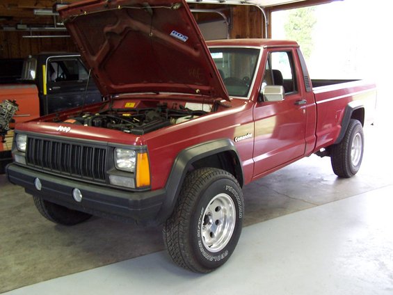

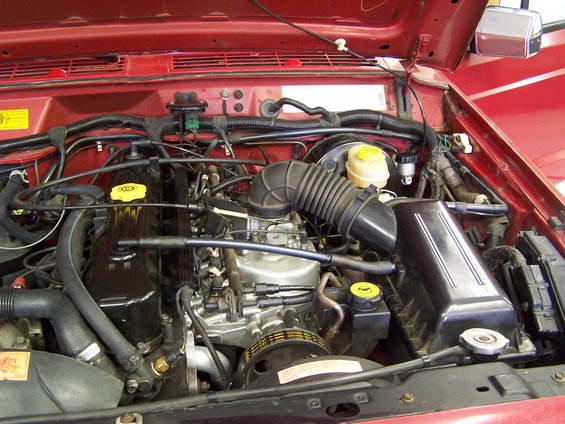

camjeep3 Posted May 23, 2010 Share Posted May 23, 2010 oh oh oh oh .... the brake booster!!! and relocated washer fluid?? Link to comment Share on other sites More sharing options...

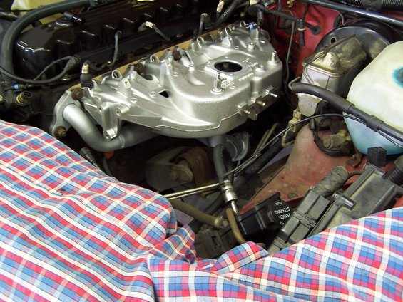

onebigmj Posted May 23, 2010 Share Posted May 23, 2010 99+ intake and newer style valve cover. Link to comment Share on other sites More sharing options...

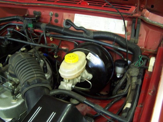

freakjeep93 Posted May 24, 2010 Share Posted May 24, 2010 newer brake mastercylinder/booster, new intake manifold. and a yellow cap on the power steering pump Link to comment Share on other sites More sharing options...
manimal Posted May 24, 2010 Share Posted May 24, 2010 Newer style:Intake,M/C and booster,and power steering pump/resevior(sp?),and relocated washer bottle....? Link to comment Share on other sites More sharing options...
87Chief Posted May 25, 2010 Share Posted May 25, 2010 New brake booster! And I'm also from the Charlotte area... Just south of it about 20-30 minutes. :-) Link to comment Share on other sites More sharing options...

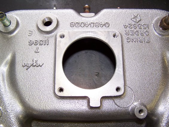

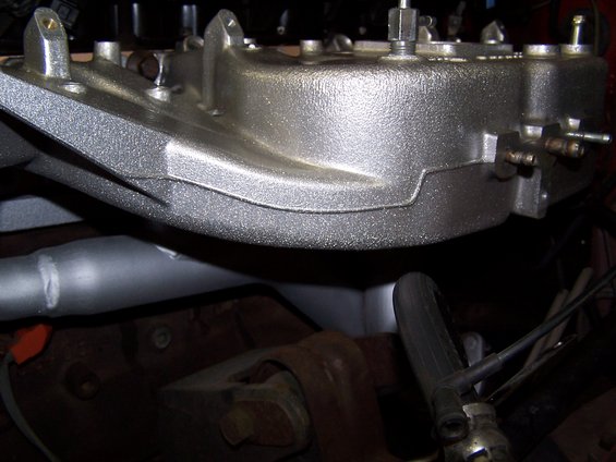

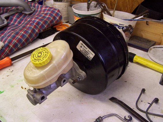

91MJdude Posted May 29, 2010 Author Share Posted May 29, 2010 yep, new intake from a 01 Grand Cherokee.(of course its never good enough so I poweder coated it sliver) $25 Made sure I cleaned the ports real good. Painted the stock exhaust manifold while I was there. other than re routing some vacuum hoses and a 96+ power steering pump its a direct swap. power did pick up some, not as much as other has stated because the engine is still stock other than a flow master. but it could had picked up just from the clean ports since the old intake was pretty gummy. id say 15hp tops Double diaphragm booster and master cylinder from a 96 Cherokee with 96k miles. $25 reused the stock proportioning block so I could reuses the rear prop valve that has 2 lines. Braking power is insanely good now. still need to make the adjustable rod for the rear prop valve. needles to say I love working on/improving my Jeep Link to comment Share on other sites More sharing options...

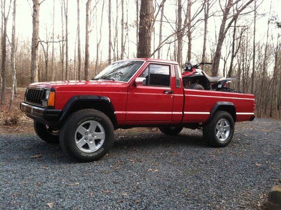

91MJdude Posted September 16, 2014 Author Share Posted September 16, 2014 Been a long time since I've updated, here is a recent pic with my new to me topper that I am undecided on color, almost like the color thats on it... Have done a lot since my last post in 2010, 4wd swap with external slave ax15, np231, front axle from WJ with sway bar and kevins trackbar, rustys lower adjustable control arms, jk wheels, 265/70r17 BFG tires. still have to get truck painted, Thats staying red for sure 220k and counting strong... easily getting 18-20 mpg mixed driving even with 4 wheel drive conversion. Link to comment Share on other sites More sharing options...

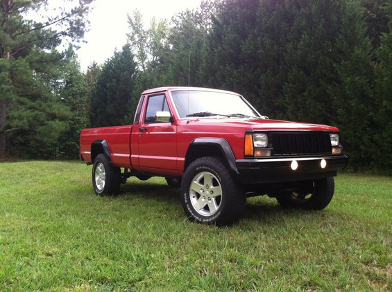

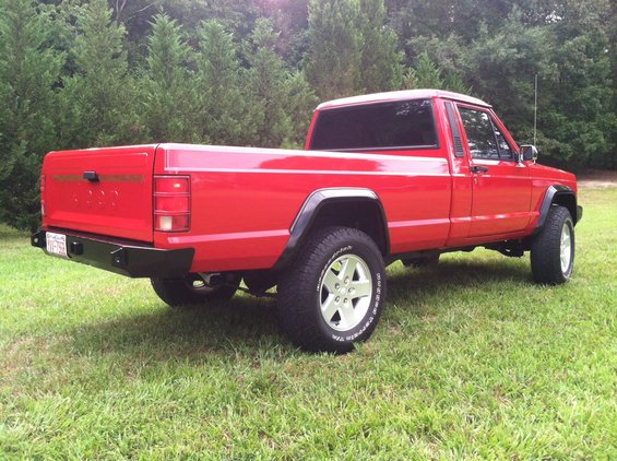

91MJdude Posted November 2, 2015 Author Share Posted November 2, 2015 well I have finally got my jeep painted. almost feels complete, which it will never be totally, always upgrading and fine tuning. I work all the time now and have not enough time to do stuff to my jeep and post pictures like I used to. Let me know what y'all think. Link to comment Share on other sites More sharing options...

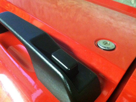

91MJdude Posted November 2, 2015 Author Share Posted November 2, 2015 just completed what TV would call a payoff... drove it to Kure Beach to go fishing and use the 4 wheel drive some. took it out on Fort Fisher (south end). caught some fish, didn't get suck, jeep does great in the sand even with Mich ltx. Had to ditch the bfg rugged terrains ( way to noisy) for my liking being my daily driver vehicle. also had to get full coverage on it to feel safe driving it. here are some detailed pictures of how clean it is... for now new cowl seal and cleaned up and waxed cowl. newer style handles painted with trim black, new gaskets behind lock cylinders. waxed door jambs, didn't opt to get painted because the paint was in decent shape. paint match is good with the ppg single stage. cleaned my interior to get all body shop dust out. well there is most of them. I'm sure thats enough. Thanks for looking. Link to comment Share on other sites More sharing options...
