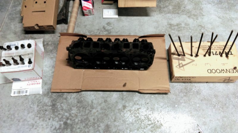

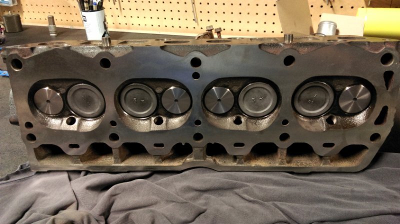

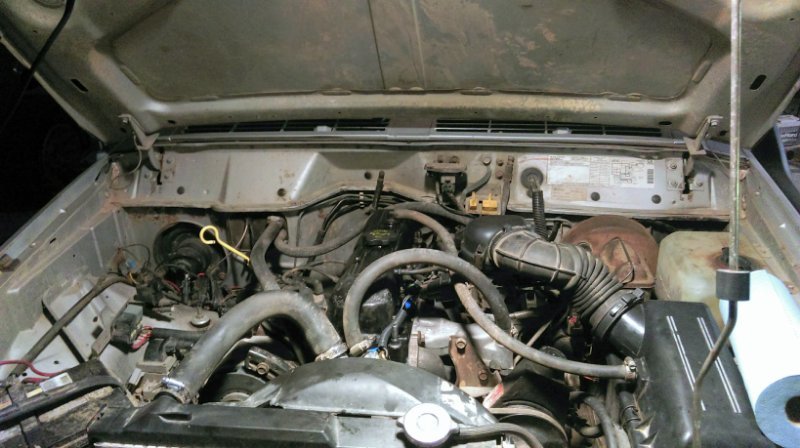

  23. Wow, it has been just short of two years since my last update with the MJ. I guess that is a good thing, it hasn't been giving me any trouble :) She now has 193k miles, 30k of those mine! A couple of weeks ago I decided to tackle a project I've been putting off since I bought this MJ, a leaky exhaust manifold. Upon a close inspection I could see the manifold was cracked, the gasket was blown out and the rear stud in the head appeared to have rusted off. Since I knew I'd need to remove the head to replace that rear stud I planned to drop it off at the machine shop who had built two 4.0's for me. The MJ came apart quite easily and I made sure to keep everything in order. While the head was getting a makeover, I cleaned every part I pulled out of the truck. With the intake cleaned up, I made a EGR block off plate. The EGR valve was frozen when I bought the truck and had been bypassed for many years. My biggest concern about this project was uncovering the bottom end of the motor. I expected to see scored cylinder walls and discoloration. Instead, all I found were smooth cylinder walls and a little carbon build up. Not bad for almost 200k miles, but it would have been awesome if there was still cross hatching on the walls. I had the head pressure checked and then rebuilt. No surprise, it needed new exhaust valves since a leak at the exhaust manifold can burn up exhaust valves. I was surprised that the valve springs and rocker arms were okay. The head work cost was more than I originally paid for the truck! This little stud was the sole reason for all of this work. The stud is from a Dorman manifold bolt kit for a 4.0. I also used a Felpro head bolt kit for a 4.0 to secure the head. I did not want to trust the 31 year old head bolts being torqued to 110/100ft-lbs. Since the old exhaust manifold was cracked at the EGR bung it needed a new manifold. I decided to try out the cheap ATP Graywerks unit. The manifold did have some extra casting I had to clean up, but it wasn't to bad. I did have to buy a new thermostat housing. The old 2.5 housing was so corroded the last time I changed the thermostat that I had to apply silicon to the gasket. The new housing is obviously for a 4.0 and has the coolant temperature sensor port. I plugged the hole with an extra renix coolant temperature sender. I will extend the wiring so that I can use this sensor for the coolant temperature to see if there is any difference in drive-ability. The MJ fired right up after the work was done. It is much more pleasant to drive without 3 big exhaust leaks right in front of me. I am anxious to see if my fuel economy improves with the sealed exhaust.
