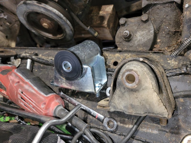

  10. Poly. Not to concerned with vibes, more concerned with movement and twisting. Next step be chaining the engine down. Progress is right. Slowly going back together. Was going to swap the 99 i take on but since I don't have it right here ill do it later. And furthermore will deal with power steering pump at same time being mounting will have to be addressed with that intake swap. Just a matter of plumbing it now as well and need to pick up heater hose and coolant filter setup.
  11. Thanks, i have been showering. New mounts are in. Little grinding to get drivers side to slide in. Not to bad. 4in grinder was tight, but with a 7 in disc be easier to get at. Made it work though. Passenger side didn't need grinddage. Best to bolt in mount before slide bolt in as its easier to pry engine around to align bolt then to align mount in its 2 holes itself. Otherwise pretty straight forward as per the directions.
  12. Awaiting package 📦 of parts. Wanna install new motor mounts before put intake back on. 🤔 hot dogs 🌭.......

      MiNi Beast
      Love the difference these make. Feel the torque now as the solid mounts firm up the engine and I love it. Peace of mind knowing things aren't shifting under different angles  and what not. Can feel drivelive vibrations but I find it to be more a tuning fork and keeps me in tune with the rig.. I would recommend these for sure. Heck I've always wanted some finally done ✔ :comanche:
