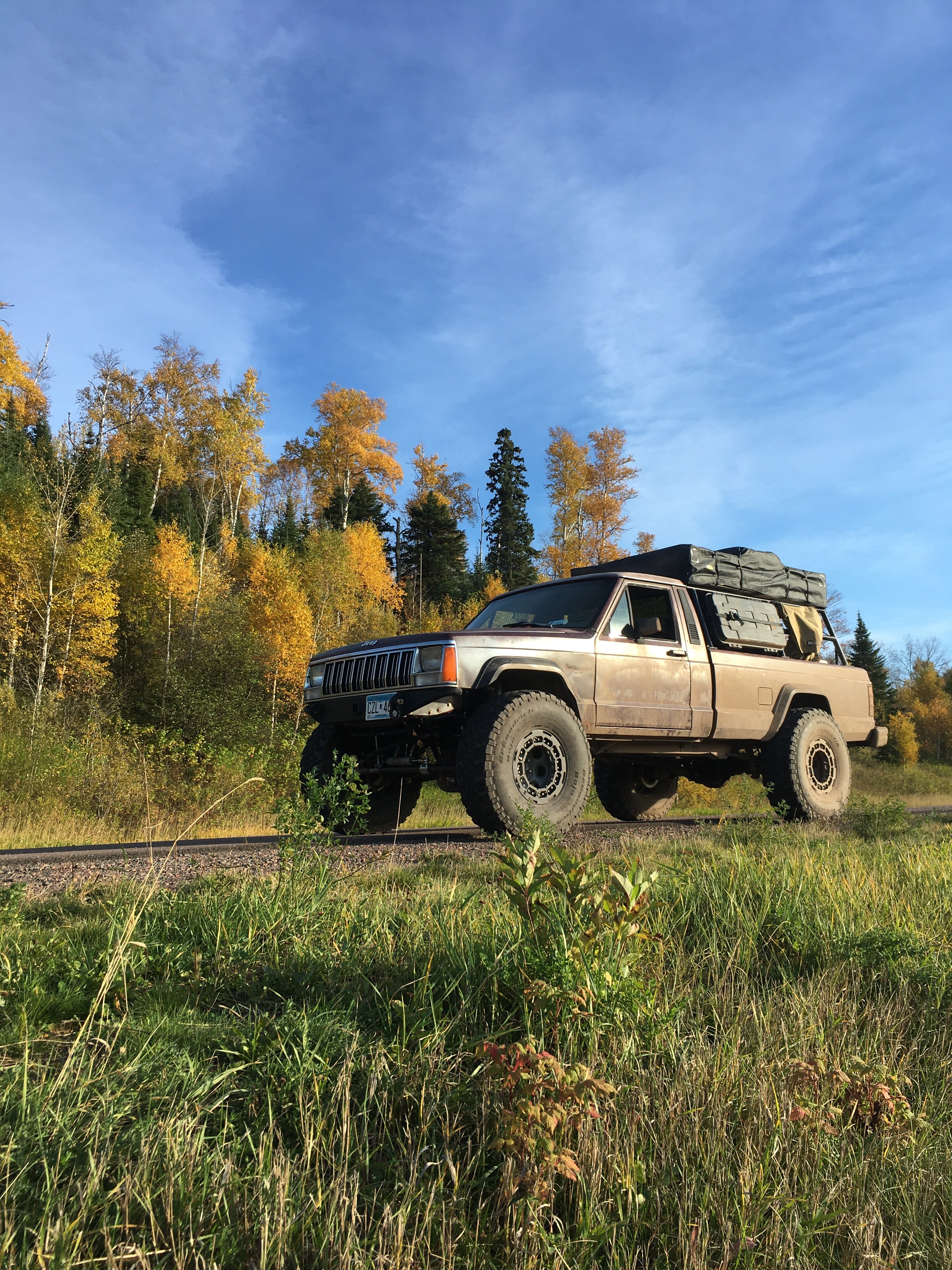

  11. Picked up a Swb 4cyl,5spd,4x4 last week to build into a crawler now that my 88lwb is done and driving nice! tentative plans are as fallows: Keep stock drive line except axles those will be a G2 44 that I will pull from my other MJ as it just does street and gravel road stuff, rear axle will be an Isuzu rodeo 44( these axles use same larger 9” ring gear at the jk rubicon’s and a pinion that rivals a d60! Will also be doing a 231/231 doubler and goal tire size is 37-40’s! will be doing 2x6 rockers full interior cage tied to bed cage and bobbing the bed I’m thinking 8”
