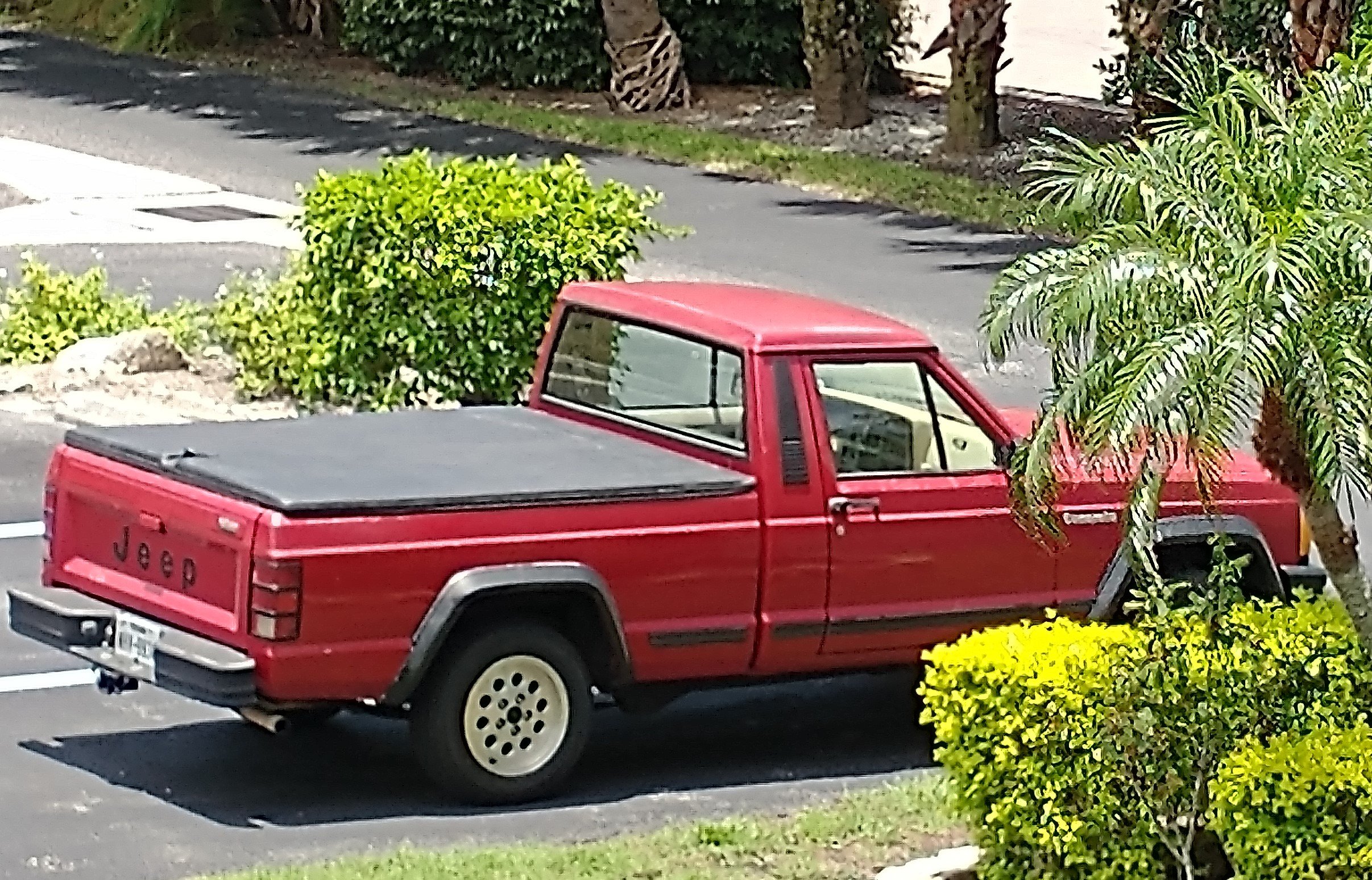

My truck has developed a slight vibration during highway driving above 65mph. Not death wobble, and not too bad but noticable enough. If I put it in neutral at speed, then back into drive, it instantly goes away for a while, and only occasionally returns. Ive replaced motor mounts, trans mount, new tires, all suspension components (ball joints, bushings, tie rods, shocks, etc) as well as the idler pulley, serpentine belt, new u joints in driveshaft, new front wheel bearings, and most recently new power steering pump and its still there. Rotated tires and its still there. It feels similar to what a "roaring" wheel bearing feels like when its going bad, but it ONLY happens at hwy speeds over 65. Since this is 2wd its the old school front wheel bearings, not the entire hub assembly like on a 4x4. I am stumped. Anyone have ideas? thx
