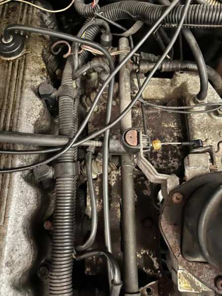

I've checked the Kickdown wire. It doesn't look like its broken, its springy when I pull it and doesn't seem loose. Though, when I try to do the adjustment reset as many show in the videos on youtube, I move it all the way back and push the throttle. The kickdownharnessthing only changes a little bit with a click. The videos show a greater change then what happens to mine.

Your English is very good. When you say the kickdown wire, it is just a metal cable inside a plastic sleeve, correct? Any chance you can take some pictures of what you're working with?

Yes, its just a metal wire in a plastic sleeve. I can fix a picture tomorrow! Thanks.
Here it is!
I manually pulled the inside of the harness to the right to adjust it today, as I've seen videos where the self adjustment does way more then it does when I do it.
What happened was that the car lost power near 60kmh and didn't shift.. I re adjusted it as it is now and it shifted again only at 60+ kmh.
Seeing that, I would assume it is somehow out of adjustment. I wish there was an easy way that we could figure out the type of transmission you have.

another point... the cable adjustment at the throttle body..  IIRC it mostly controls the line pressure,  or am I incorrect on this point... ???
You are correct, that line only controls the pressure. the toyota version of the AW4 had an electrical thingie instead of a wire that we have.  "kickdown" comes from the TPS sensor
I keep my pressure wire thing ziptied to about 70%. But I don't use the TCU for my aw4.
