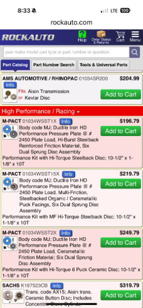

InTacosWeTrust Posted Wednesday at 12:37 PM Author Share Posted Wednesday at 12:37 PM Does anyone have any insight on these m-pact clutch kits off rock auto? I talked to one of the techs over the phone to gain more insight and overall for my use of the truck and applications he recommended the M-PACT 01034WSST1X Clutch kit Link to comment Share on other sites More sharing options...
InTacosWeTrust Posted Wednesday at 12:53 PM Author Share Posted Wednesday at 12:53 PM 10 hours ago, ghetdjc320 said: The AA is a good kit. Grab the best throwout bearing you can find though. Or, just stick with a quality internal slave setup and run Redline, 10w30 synthetic motor oil or whatever else works with the brass synchros. Luk Rep-Set has been a pretty good clutch option. Going over 8 lift on 35's will help you refocus to other problems aside from the tranny when I replaced my clutch, master and slave a year ago, I replaced it with the LUK 01034 Clutch Kit, I’m not denying it, but honestly it’s hard to wrap my head around and believe that the slave, or even clutch has failed since everyone in this club pretty much recommends and says it’s one of the best kits to get, but things do fail no matter how many good reviews, it’s just hard to believe you know, but like Htchevyii said, his failed after 10k miles. Link to comment Share on other sites More sharing options...
