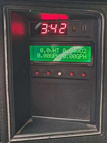

NC Tom Posted May 4, 2025 Author Share Posted May 4, 2025 @89 MJ@Pete M@ghetdjc320 Thanks guys. I have an REM that I'm installing today. However, I'm not finding an easy path from the engine bay to the cab interior. Link to comment Share on other sites More sharing options...
89 MJ Posted May 4, 2025 Share Posted May 4, 2025 I ran the cable for mine across the firewall and then inside the cab near the brake booster and fuse block area if I remember correctly. You don’t necessarily need it inside the cab with though. It might be nice to have it so you can walk around the engine compartment with it in your hand. Link to comment Share on other sites More sharing options...
NC Tom Posted May 4, 2025 Author Share Posted May 4, 2025 1 hour ago, 89 MJ said: I ran the cable for mine across the firewall and then inside the cab near the brake booster and fuse block area if I remember correctly. You don’t necessarily need it inside the cab with though. It might be nice to have it so you can walk around the engine compartment with it in your hand. Yeah, right after I posted I went back out used that same hole. I decided to mount it inside. Unfortunately, it doesn't fit tight. It's too far left and overlaps the screen a bit and I can't set the clock. Looks like a I'll need to modify the dash a bit. BTW, how the hell do you get the dash cover off? I've cracked mine. It will break in half next time I try. Link to comment Share on other sites More sharing options...

pizzaman09 Posted May 5, 2025 Share Posted May 5, 2025 I'm surprised the REM isn't centered in the hole, mine is dead center. Was your original clock in the center or did you just have a blank panel? I almost wonder if you managed to get it installed to the left of the mounting screw. Link to comment Share on other sites More sharing options...
NC Tom Posted May 5, 2025 Author Share Posted May 5, 2025 On 5/4/2025 at 6:21 PM, AnotherOldJeepGuy said: I usually park in the sun with windows up for a while to make sure the plastic is nice and warm. Of course once the crack has started that might not help. If the crack is clean you might glue it back together with E6000, that stuff is really strong and retains some flexibility. I hunted down cure times since that is not on the packaging and found something about 72 hours for maximum, so I generally let it set for 3 days. It's pretty clean. Warming the plastic is a good idea. Link to comment Share on other sites More sharing options...
NC Tom Posted May 5, 2025 Author Share Posted May 5, 2025 31 minutes ago, pizzaman09 said: I'm surprised the REM isn't centered in the hole, mine is dead center. Was your original clock in the center or did you just have a blank panel? I almost wonder if you managed to get it installed to the left of the mounting screw. It's odd. I had replaced the factory clock. Mounting holes all line up. I thought maybe I could loosen it and shift it over, but there is no play there. I may go back and enlarge holes, with a hole stretcher of course, to get a little shifting room. Link to comment Share on other sites More sharing options...
