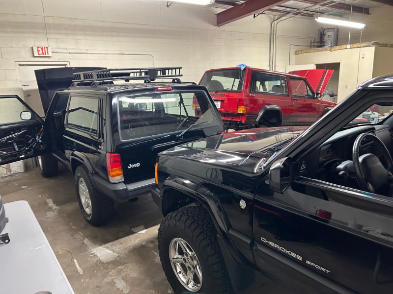

Red Mistress Posted May 28, 2025 Author Share Posted May 28, 2025 Been driving the Eliminator a bunch, about to hit 130K of trouble free miles. It’s the best shop truck / light hauler. I really need another 91-92 MJ so I can restore this good runner. Been working on XJ Chief and a 99 XJ 2 door. Link to comment Share on other sites More sharing options...

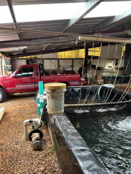

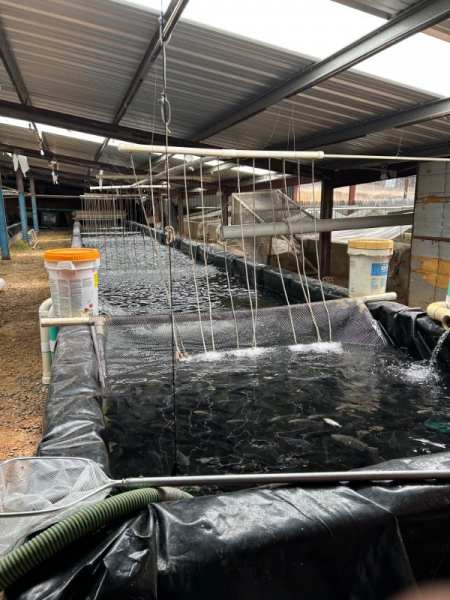

fiatslug87 Posted May 28, 2025 Share Posted May 28, 2025 What’s in that pond? Link to comment Share on other sites More sharing options...
watchamakalit Posted May 29, 2025 Share Posted May 29, 2025 Looks like some sort of dip tank. Electrolysis cleaning bath or acid bath? Link to comment Share on other sites More sharing options...
Red Mistress Posted June 3, 2025 Author Share Posted June 3, 2025 Indoor ponds for overwintering Tilapia fish for keeping pond clean. Comanche earning its keep hauling them. Link to comment Share on other sites More sharing options...

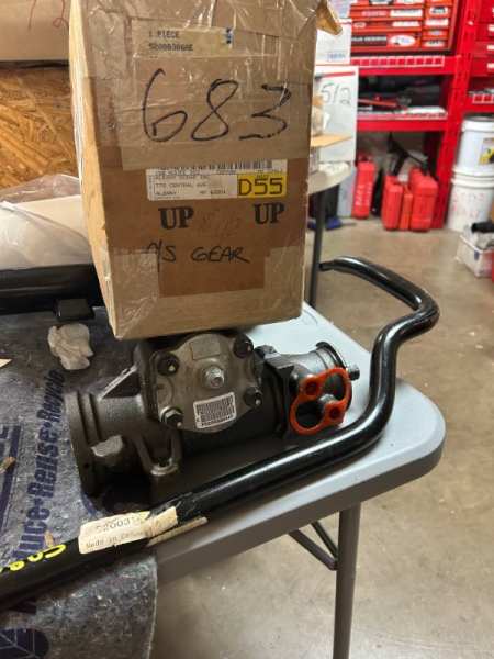

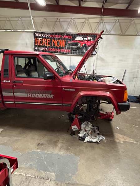

Red Mistress Posted August 26, 2025 Author Share Posted August 26, 2025 MJ down due to steering binding. Time use up some NOS Power steering gearbox is for 2000-01 wonder what difference if any thru years? 28mm sway bar will definitely tighten up things. And tossed in some fresh spicer ball joints. Link to comment Share on other sites More sharing options...
