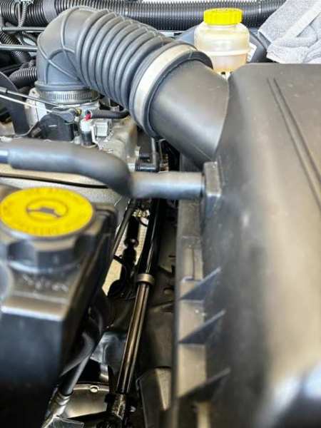

Gjeep Posted October 24, 2019 Author Share Posted October 24, 2019 Done but they're not permanently mounted yet as I'm going to wait until I paint the truck. Unfortunately/ fortunately, I had to go back to the factory air box as the k&n filter charger kit was too high even if I trimmed the louvers. Volant air intake kit didn’t work either for the same reason. I'm surprised how much I like the look of the louvers. I actually like it better than the XJ cowl hood. For some reason I only think cowls belong on Chevy's. Link to comment Share on other sites More sharing options...
