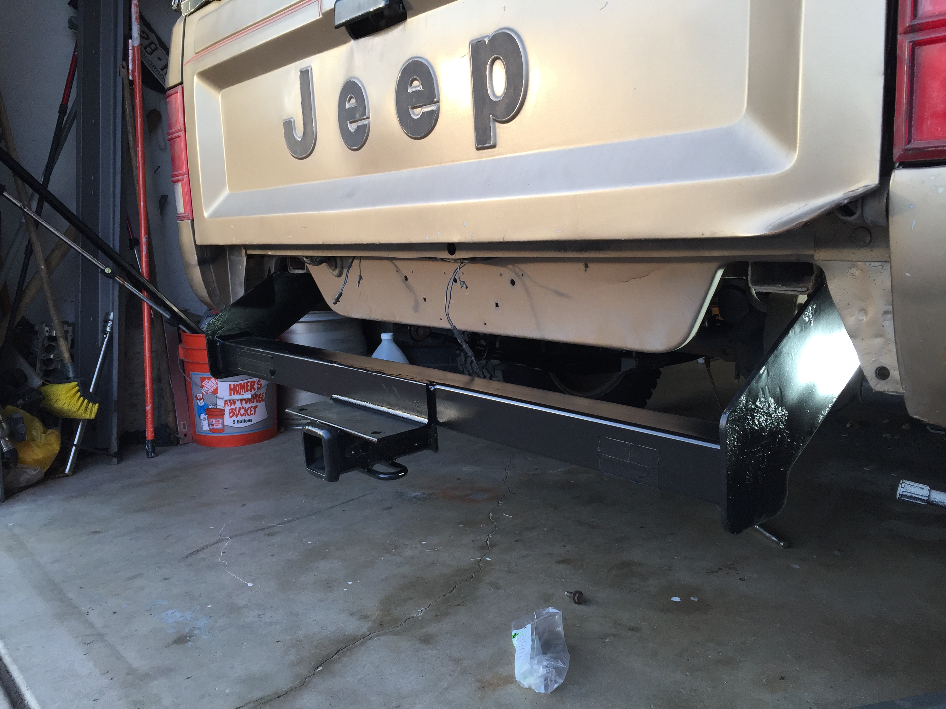

Sir Sam Posted January 30, 2018 Posted January 30, 2018 I finally got the hitch I pulled off a longbed MJ in Feb of 2010 installed.....aaaannnnddd that sucker sticks down way too low. I don't want to use it. Yup, too low. Been saving that draw tight class 3 hitch for years but haven't put it on. Time to move on. So thinking about my options we are lucky these days that there are some things available for us. This was a good thread talking about it as well: Built in Hitch for towing - I plan to tow up to 5k lbs.(not sure any aftermarket bumpers will have a rating, but good for towing is a consideration, ease of access to pin, etc) Flat face for LEDs - I would like to recess some LED floods into the bumper, so a flat face that allows that is required. Larger top step - The wildernest topper is pretty heavy, and its helpful for opening it to have a bumper to step on, though I suppose the tailgate could work too. That said it seems like there are several things that could work out for me very well, for those of you that have these bumpers I wanted to know your opinion of them given my criteria above. Hanson: JCR DIY (lip looks smaller than hanson: Nates(lip looks pretty small for standing but hitch/chain hookup looks better): License plate mounting is all about the same between the options - $#!&ty. Based on my useage criteria, what do you'll think is the best option for me or what do you think I will like or not like about various options? Another to throw into the mix, but I am a little unclear of the cost with the trailer hitch: https://www.dirtboundoffroad.com/manta-ray-rear-mj-bumper.html I missed that because I didn't see the hitch option earlier. I still don't see how much it costs with the hitch and the hitch does stick down a bit lower, but it seems like a decent option w/ hitch. I bet by the time I add the hitch from them I am looking at similar cost as the Hanson. I guess I need to call em to find out about the hitch cost.
HOrnbrod Posted January 30, 2018 Posted January 30, 2018 The Draw-Tite hitch is just right for the stock step bumper.
Sir Sam Posted January 30, 2018 Author Posted January 30, 2018 7 minutes ago, HOrnbrod said: The Draw-Tite hitch is just right for the stock step bumper. I know.....but I don't have a stock bumper and finding one is.......difficult. Even then, after looking at the clearance I don't think the stock setup will work for me with the offroading I do.

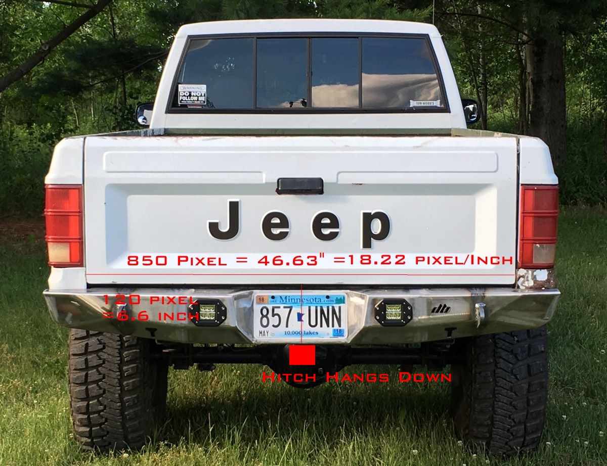

Sir Sam Posted January 31, 2018 Author Posted January 31, 2018 I did some maths. Based on my best estimation this is where the receiver will sit on the Manta Ray with the hitch option, still lower than I would like: Compared to draw tight: A license plate is 6" tall and with a little gap between bumper and plat that puts the top of the receiver at about 6.5-7" below the tailgate lip. So, clearance would be better, but I would still have that one point sticking out down low on the Manta ray.
Sir Sam Posted January 31, 2018 Author Posted January 31, 2018 A hitch is available for the dirtbound offroad, though it sticks down. I tried to reach out to dirtbound today and got the Voicemail of the sales team, instead sent an email inquiry about the pricing for the hitch. At this point its coming down the the JCR and Hanson I think, though I would still like to figure out the final price of the dirtbound. I do like the way the JCR wraps around the side, I like the protection that offers when backing up/turning around on the narrow trails in CO, it gives me a chance to put a corner of the jeep into a mountainside without bashing it up.: And I like that the Hanson has a larger top step for dealing with opening the Wildernest - though I could just put down the tailgate and step on that. Combined with some grip tape could make it pretty safe for standing on the bumper edge:
