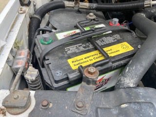

fiatslug87 Posted April 26 Posted April 26 21 minutes ago, llhat said: so a group 34 over the standard ?? group 58? I can see the spec comparison 500+ CCA versus 800 CCA for the group 34... so the dimensions are the same? Group 34 is larger, taller but will fit the battery tray and not hit the hood. If you have the little OEM bracket that bolts to the radiator support it has to be flipped over, that’s it. Group 34:
eaglescout526 Posted April 26 Posted April 26 Speaking of group 34. They will not fit in the 84-86 battery tray. You have to stick with 58 for those years. Learned the fun way.
fiatslug87 Posted April 26 Posted April 26 1 minute ago, eaglescout526 said: Speaking of group 34. They will not fit in the 84-86 battery tray. You have to stick with 58 for those years. Learned the fun way. Good to know

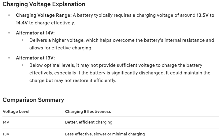

pizzaman09 Posted April 27 Posted April 27 I just put a group 34 Interstate in mine to replace the groupe 56 Interstate that was in it that has been on its last legs since the day I bought the truck three years ago. I usually buy the Walmart batteries but I had a horrid experience with trying to get a Warranty on one and wrote off ever doing that again. From a cranking speed standpoint, the new battery significantly sped it up but after a couple weeks it doesn't crank as fast as it had when the bat was fresh. I wonder if I'm not quite charging at a high enough voltage. My REM tends to show mid to low 13V when running.
AnotherOldJeepGuy Posted April 27 Posted April 27 My charging voltage is something over 14, but don't remember how much. According to the internet 13.5V seems to be the low end of the expected number and below that, as you suggested, may not get you to a full charge. I suppose it could be the voltage regulator rather than the alternator, not sure how to know which other than by trial and error.
eaglescout526 Posted April 27 Posted April 27 25 minutes ago, AnotherOldJeepGuy said: My charging voltage is something over 14, but don't remember how much. According to the internet 13.5V seems to be the low end of the expected number and below that, as you suggested, may not get you to a full charge. I suppose it could be the voltage regulator rather than the alternator, not sure how to know which other than by trial and error. Ok let’s not turn this one into a charging/alt thread.
coheed Posted April 27 Posted April 27 15 hours ago, eaglescout526 said: Speaking of group 34. They will not fit in the 84-86 battery tray. You have to stick with 58 for those years. Learned the fun way. Interesting that you say this. Both of my 86s, one early and one late, both had the same battery tray in them and the group 34 battery fits. I just had to flip the hold down wedge. As far as an actual battery goes I've had an Interstate MTP-78DT in my truck for a few years and been very happy with it. I know most people don't need the dual terminal though. It's even sat for months while I was doing my engine swap, and a day on a 2amp charge and it's perfectly healthy again.
eaglescout526 Posted April 27 Posted April 27 3 hours ago, coheed said: Interesting that you say this. Both of my 86s, one early and one late, both had the same battery tray in them and the group 34 battery fits. I just had to flip the hold down wedge. Well I’ll be damned.
Gojira94 Posted April 27 Posted April 27 I'm also running a 34. And running the plastic tray for now. With a taller battery and the plastic tray, I recommend terminal covers of some sort in case the tray cracks/ breaks.
