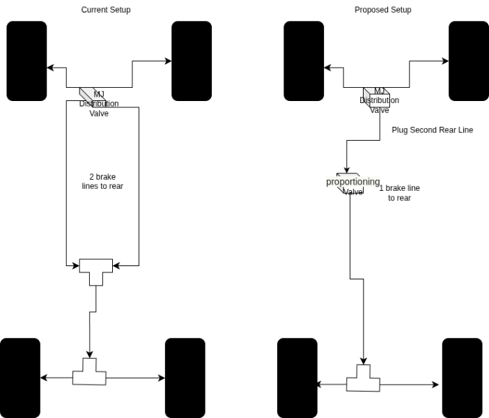

dotnetrob Posted August 29 Author Share Posted August 29 Finally have an update. Broken and rusted shut bleeders, 1 rotor was in bad shape, rusted onto the wheel bearing and corners of the rotor was all beat up. Rusted on dust covers, or what was left of them. 1 of the pads on the passenger side was partially broken, 1/4 of the pad was missing. The driver side drive shaft nut would not come off, so removed the drive shaft with wheel bearing all in one piece. With all the carnage, everything needed to be replaced. Cleaned and painted knuckles Replaced the drive side drive shaft. new axles nuts and caps on both sides Installed 2 new wheel bearings. Installed 2 new dust shields. Installed 2 new rotors. Installed 2 new calipers Installed new brake pads on both sides. All installed and front brakes bleed. Was going to do a CAD delete while I was at it but need to stay on task for now and get the brakes working. After taking a quick test drive, there is an improvement. Not huge, but noticeable. Would say before I replaced all the front brakes, braking power was maybe 20%, would say its maybe 30% now. Still horribly weak, but does stop better. On 8/6/2025 at 8:12 PM, coolwind57 said: Page 5 of one of my write-ups shows what I did to delete a few things. Something for you to have a look at. Might get you some ideas. Good luck, friend. It's about half way down page 5: After looking at @coolwind57 write up. I believe I am going to add a proportioning value up front near the master cylinder for the rear brakes and convert the rear brakes to 1 line to the rear. Anyone see any issues with this idea? Attached a horribly drawn diagram of the current and proposed setup. Link to comment Share on other sites More sharing options...

dotnetrob Posted November 15 Author Share Posted November 15 Alright, finally updating the long, still on going saga that is my Comanche's brakes. The stock Comanche distribution value fittings were so rusty that even heat and penetrating oil couldn't help, ended up breaking multiple fittings and lines trying to get things apart. Tried making some new brake lines but apparently I am incapable to making a good double flare, even bought a different tool and ultimately decided my dream of becoming as a good brake line flairer was not meant to be. So I gave up... Ended up calling a local 4x4 shop I had used many many times on both my JK and TJ. Had them come get my MJ, since I had now messed up the brakes pretty good. They decided the best route was to replace the distribution value with one from an XJ and replaced about 1/2 of one of the lines going to the rear. So now just 1 line going to the rear from the XJ valve. Was going to have them do some other work since I like being lazy, but for some reason they pretty much just sat on my MJ and didn't make much progress past the XJ distribution valve, kind of frustrated they had it a month. They mentioned the rear brake where making noise when stopping but they said the brakes were much better. So I got excited and decided to go ahead and pick it up and for go any other work, heck the brakes should work now right.... Picked it up late yesterday evening and drove it home. The brake pedal is a little better, not a mushy pedal 80% of the way down, brakes feel... better, maybe, a little, but still feels weak to me. But drove it home 80+ miles in rush hour traffic, was a bit of a rough experience, but it made it home. Today took it out for a drive to get lunch with my son and it was a horrible experience. Brakes still feel weak, pedal is a bit mushy. But I have all new brakes up front(everything), rear brakes are rebuilt( by other local shop), and now have an XJ distribution valve. At the second stop light I came too, had to brake a bit hard, light turned as just the right time, wasn't even close to an emergency stop, but the rear brakes locked up hard, took the comanche a good bit side ways. Extremely frustrated with myself, the shop. Maybe the rear drum brakes need to be adjusted, unfortunately I know so little about drum brakes, except I worked on them as a teen with my first truck a few times and have hated them since. Don't really want to take it back to the shop, long drive, owner is apparently on vacation again and he is apparently the one I would need to talk to but he won't call me. I guess I am hard to work with or people just don't like me. Maybe both... Either way, I once again have an undriveable comanche that needs tons of work... but I can't even get the brakes working why work on the rest. Link to comment Share on other sites More sharing options...

dotnetrob Posted November 20 Author Share Posted November 20 Finally have working brakes on my comanche. Took it to a different shop and had them diagnose the issue. Looks like the rear brakes that were fixed/repairs/replaced by the first shop were not done very well and also needed adjustment. So the XJ distribution valve worked. Super happy to finally have a drive-able comanche. Now to start work on the other 100 things on the to fix list. Link to comment Share on other sites More sharing options...
dotnetrob Posted Wednesday at 10:36 PM Author Share Posted Wednesday at 10:36 PM Yet another update. Guess I didn't test the XJ distribution value enough before posting success. The XJ distribution valve indeed does work better, but is not even close to perfect. It still locks up the rear even when braking lightly. Working on a new plan. Link to comment Share on other sites More sharing options...
Pete M Posted Wednesday at 11:03 PM Share Posted Wednesday at 11:03 PM I added an inline prop valve for the rear. highly recommended. Link to comment Share on other sites More sharing options...
Eagle_SX4 Posted Thursday at 01:34 AM Share Posted Thursday at 01:34 AM I used a Wildwood adjustable proportioning valve when I replaced mine. At the same time I deleted the rear height sensing valve. Do you still have the rear valve (mounted above the rear axle) on your truck? Link to comment Share on other sites More sharing options...
dotnetrob Posted 9 hours ago Author Share Posted 9 hours ago On 12/10/2025 at 7:34 PM, Eagle_SX4 said: I used a Wildwood adjustable proportioning valve when I replaced mine. At the same time I deleted the rear height sensing valve. Do you still have the rear valve (mounted above the rear axle) on your truck? Rear valve has already rusted thru and disconnected when I got the comanche unfortunately. Just installed a adjustable proportioning valve from Jegs, so far so good. Link to comment Share on other sites More sharing options...
