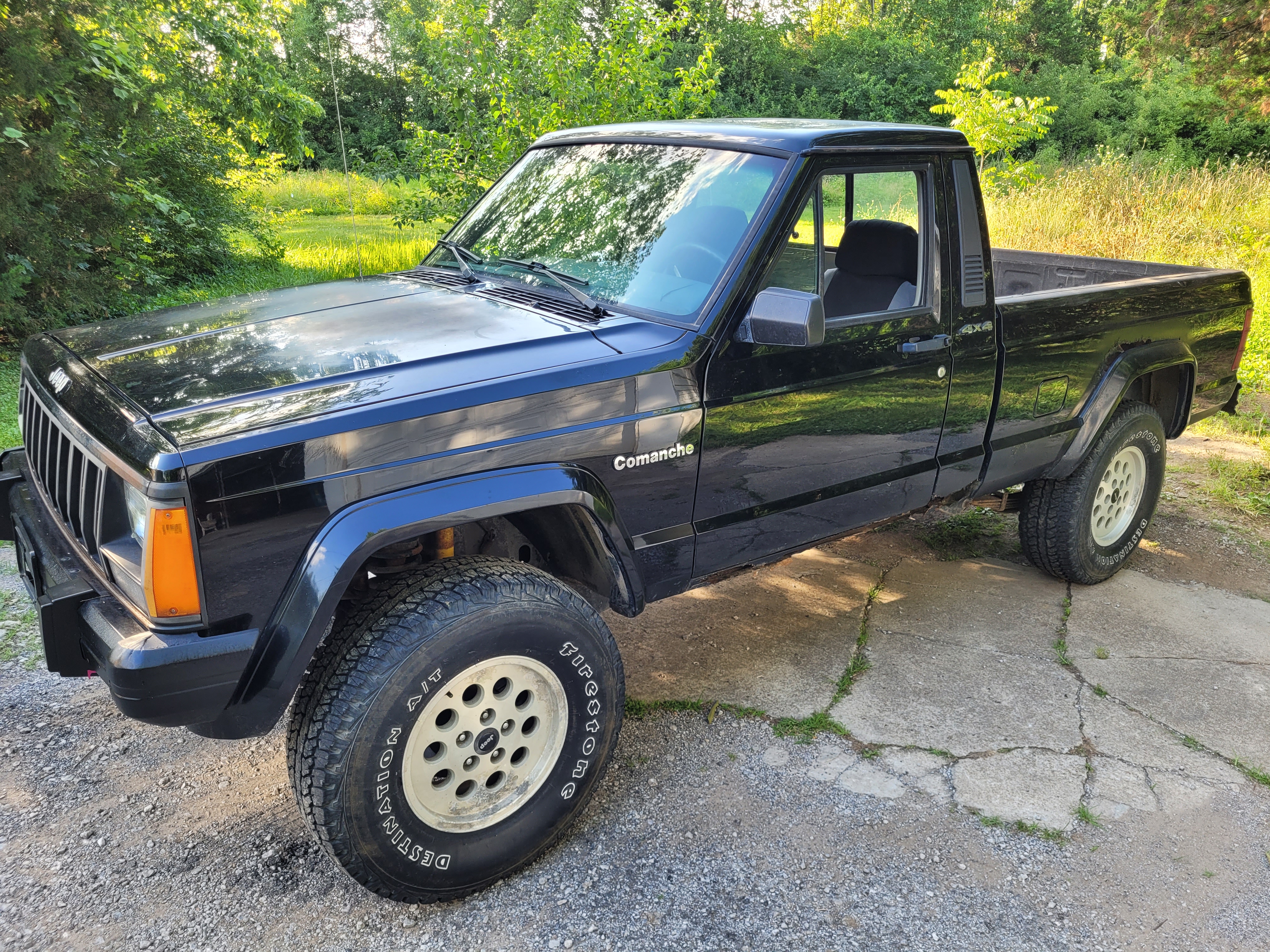

Bought my 1989 Jeep Comanche Pioneer 4x4 Auto with 4.0L with 189k on it 2 months ago today. Had looked at multiple comanches trying to find one to repair/restore, choose what I thought was the best of my options at the time. Now I am wondering if I made a horrible mistake. Have no real life friends so I have no one to slap me the back of the head and tell me I am an idiot. Looking for some advise on if I should keep pushing ahead or admit I made a mistake and its time to take old yeller out back. I know this comanche had alot of rust, body and part of the cab floor need alot of repairs. Frame was pretty rusty but couldn't find any holes on this one, others had holes in the frame or other damage, so was hoping to clean it up the frame. Engine runs good even has working A/C, and besides the No Start Issue that turned out to be the fuel pump coming disconnected inside the tank, when I got it home, the engine seems solid enough. Purchased it and drove it home 500+ miles. Had no issues except the weak brakes. Rear brakes had a leak, and the load sensing valve was not working, so failed state inspection and had to have a shop do some repairs to get it approved. Brakes now work but are still very weak . While trying to fix the brakes, found the front has not been bleed for years and may not be working well and everything on the axle is rusted shut. Bleeders snapped off. Was going to take it all apart, replace the calipers, rotors, etc.... But it keeps getting worse. The passenger side came apart easy, caliper came off, rotor came right off. The driver side, caliper came off easy, but rotor was rusted on and the edges of the rotor looked in bad shape, had to beat the rotor off. The dust cover on both sides is completely rusted apart, passenger dust cover is 1/2 still there, the driver side is all rusted away, only pieces left. Decided to pull the hubs so I could clean everything up and replace the dust covers... but that is were the fun stopped or started, depends on your perspective. The hubs are rusted to the axle or at least the knuckle. On the passenger side, got the axle nut off easy, took off the 3 hub bolts off and the hub will not come off. The driver side is worse, can't even get the axle nut off, an impact and 4ft breaker bar and it won't move. And the driver side has the same hub issue, all 3 hub bolts are out and hub is just rusted to the axle/steering knuckles. Have sprayed alot of pb blaster and used many methods of persuasion, and I can't get either hubs off. Guess I can try just taking the knuckle off, with everything still attached... never tried that, not sure it would work. Now I am questioning if all this work is going to be worth it. Is the axle going to have even more rust related issues even if I work past the hub/brake issues. If I go find another axle to swap it out for, am I just putting a good axle on a rusty pos that needs to be taken out back. Picture is from the day I got it home, back when the brakes were even worse and a picture of the front, you can see the rusted out dust cover. But its a good shots of the rust.
