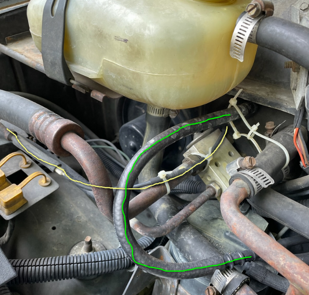

AnotherOldJeepGuy Posted May 11, 2025 Share Posted May 11, 2025 The hose I had to fix (several times) to get air back from defrost only, is the one along the yellow line. At the firewall there is a grommet that passes two hoses, the yellow line and the green line. My green line also broke but that one did not cause the defrost out only issue, it has something to do with the heater control. As you can see I have attempted to keep it from breaking yet again by bracing it multiple places with tie wraps. But at some point it will probably go , it is very brittle. Link to comment Share on other sites More sharing options...

NC Tom Posted May 11, 2025 Author Share Posted May 11, 2025 3 hours ago, AnotherOldJeepGuy said: The hose I had to fix (several times) to get air back from defrost only, is the one along the yellow line. At the firewall there is a grommet that passes two hoses, the yellow line and the green line. My green line also broke but that one did not cause the defrost out only issue, it has something to do with the heater control. As you can see I have attempted to keep it from breaking yet again by bracing it multiple places with tie wraps. But at some point it will probably go , it is very brittle. That's interesting. I'll check it out. Link to comment Share on other sites More sharing options...
AnotherOldJeepGuy Posted May 11, 2025 Share Posted May 11, 2025 1 hour ago, NC Tom said: That's interesting. I'll check it out. Be very gentle with this hose and especially take care not to break it at the firewall, I don't know what is on the other side exactly, or how hard it might be to get to that end! Link to comment Share on other sites More sharing options...
watchamakalit Posted May 12, 2025 Share Posted May 12, 2025 9 hours ago, AnotherOldJeepGuy said: Be very gentle with this hose and especially take care not to break it at the firewall, I don't know what is on the other side exactly, or how hard it might be to get to that end! It is the vacuum line that runs the heater\ac control. They are a hard plastic line factory. Link to comment Share on other sites More sharing options...
