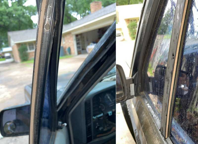

AnotherOldJeepGuy Posted May 21 Posted May 21 I'll be watching cause I have this problem on my car with new door seals that are about 1 year old at this point. This doesn't answer your question, but for cabin noise I cleaned out the window frame/guide and put in basic self-stick weather stripping, approx 3/8" thick and 1/4" wide, and it made a huge difference in the cabin noise at speeds over 50 or so. I did this probably 5 years ago and so far it's still in good condition.

AnotherOldJeepGuy Posted May 21 Posted May 21 3 minutes ago, NickyV said: Now I just gotta figure out if there's a way to improve my vent window seals. They are pretty good... they don't really let water in unless it is absolutely dumping outside. But they do whistle a little bit. I can get that to stop if I apply more inward pressure (the quarter trick). But I'm still chasing that "as little wind noise as possible" ride. I'll probably start a new thread about that soon. I don't have vent windows, but would a variant of what I posted with the window stripping work for this?
NickyV Posted May 21 Posted May 21 12 minutes ago, AnotherOldJeepGuy said: I don't have vent windows, but would a variant of what I posted with the window stripping work for this? I've already added your pictures to my notes! Liquid electrical tape is the only thing I can think of that I'd be able to paint on, and that would dry/cure in such a way that it wouldn't end up sticking to the surface of the window. Maybe there is some other product that I'm unaware of? I might also try something similar to what you did. Maybe I could glue a really thin strip of weather stripping to the inside edge of the gasket flaps to increase the contact between gasket and window. Whatever I do, I want to be smart about it. My current vent window gaskets are truly in pretty darn good shape. I don't want to mess them up by making perfect the enemy of good. But also... I can get kind of obsessive over details like this. So, I'm open to any and all ideas!
