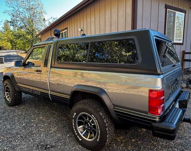

I was surprised that after a couple hours of looking with the eye to buy, I found an almost all original 85K ’91 MJ Pioneer SB 2WD AW4 column shift non-AC, Silver Star Metallic with Sand interior truck. Only things added that were not off the assembly line: an XJ wood grain dash overlay & switch pod, cherry wood Jeep logo’d steering wheel, 8-ball shifter knob and newer XJ Ecco wheels. The MJ was repainted 9 years back and although the body paint is still sharp, the fender flares need a repaint. Rear bumper is slightly twisted, but I’ll get that straightened out – and then add a few bells and whistles to make this MJ mine. The camper shell will be tossed before I even pull into the driveway.

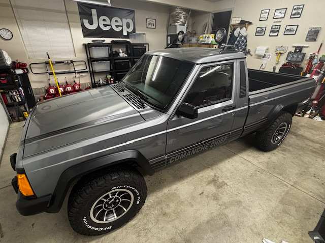

The MJ gets an updated look— 235/75 BFG’s, era appropriate steelies, and gone is is the hideous camper shell.

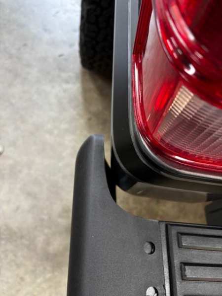

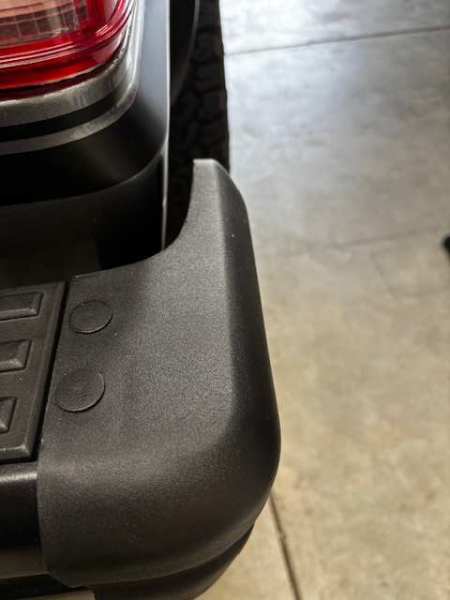

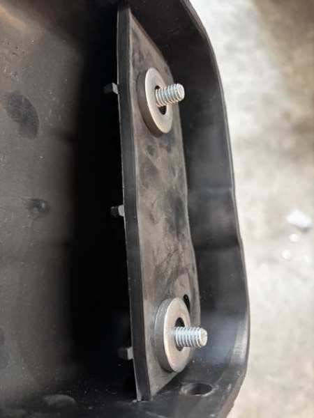

Key Parts parts installed – new set of repop taillights and linkage bumper set. As always, I try to avoid installing with rivets, so a stainless steel truss screw was used instead.
