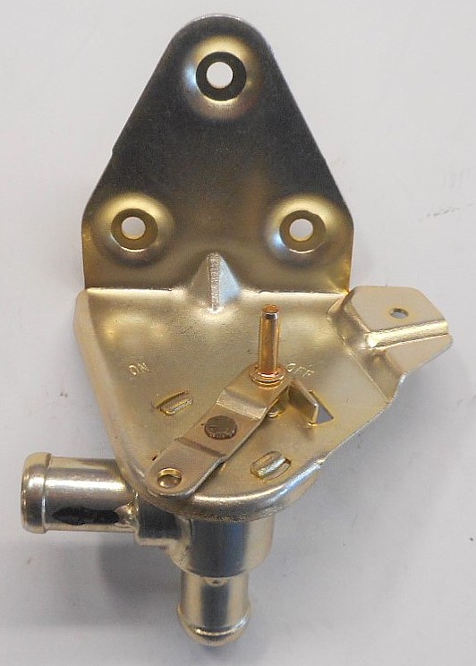

Eagle Posted April 2, 2022 Posted April 2, 2022 13 hours ago, SoloRiderForever said: Thanx Eagle. Replacing heater cores is usually a pain, but in talking with Gjeep it sounds like these have a little extra pain to them. Fortunately with the temp swings in Colorado you usually use the heat and air if you simply drive day and night. Back in analog days (the 1960s and 1970s), AMC cars had a heater control valve that was operated by a simple choke-type cable by a lever on the dashboard. There were two versions: one had the inlet screwed into a threaded port on the head and a hose connection on the outlet; the other mounted to the firewall and had hose connections for both inlet and outlet. They were simple, and they worked. I often wonder if all the fancy control gizmos we see on modern vehicles are really better than the simple, analog controls we had when I was learning how to drive and to wrench. http://www.americanpartsdepot.net/images/130 3501H.JPG
