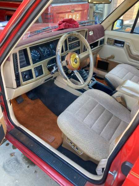

Looking mostly there lol. Went to change the shift knob out and discovered the threads have been completely sheared off the stick.
Every time I do one thing it’s got story behind it lol.
I had to charge the battery due to some neglect from someone starting him once a week but things in WA seem to corrode pretty damn fast. Also neglecting changing the ground cable, but I have to lay on the wet grass to get to the bolt. Aw hell I might do it anyways tomorrow.
Also there will be a tour tour video of chunk come tomorrow. This was a completely short planned visit but it’s my girls birthday and I have a three day weekend from work and decided it would be nice to go for the weekend.
Nice , it’s always something lol , can’t wait to see more on the beauty
